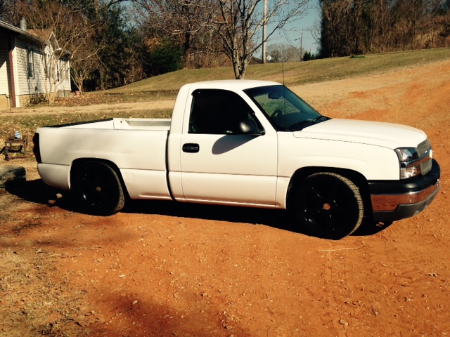

After installing my Mcgaughy 4/6 drop with cnotch and helper bags on my 04 silverado i feel like i'm in a log truck! Who else feels that way? Be honest! It looks BADASS, but rides like crap. any tricks or do I live with it?

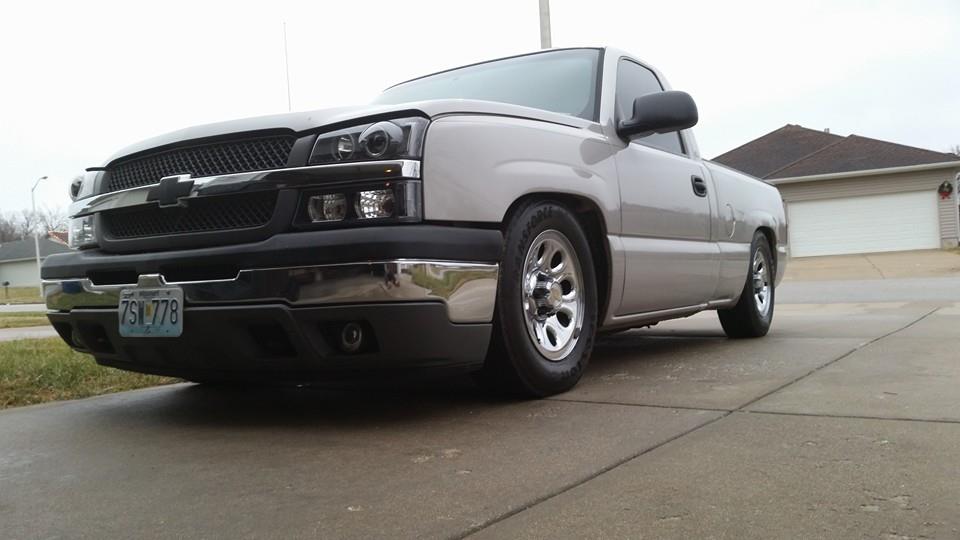

DJM control arms top and bottom up front and flip kit out back/1" Drop Shackle. Stock front spring/rear leafs. Rides like stock : ) 4/7 Drop

My discovery is that the front & rear has to be balanced. The Vikings I have in back were almost worthless until I put the Belltech front struts on. The truck rides so much better now.
Another thing is to get the proper length shocks after you drop it. I blew out the rear factory shocks in about a week after I dropped my truck.

What shocks (& length) are you using?
Old Dec 19, 2014 | 06:03 PM
Mike1992's Avatar
Joined: Nov 2014
Posts: 44
From: Springfield, Mo
DJM Shocks all around
These are whats up front
1415 Calmax SuperShox | DJM Suspension

I cut off some of the factory bump stop on my front control arms last night. It seem to help with a little more travel. I also expected my repair leaves to be here today to fix my rear springs. It sits too low so I've been running a little air in my helper bags to sit level and this magnifies the rough ride
