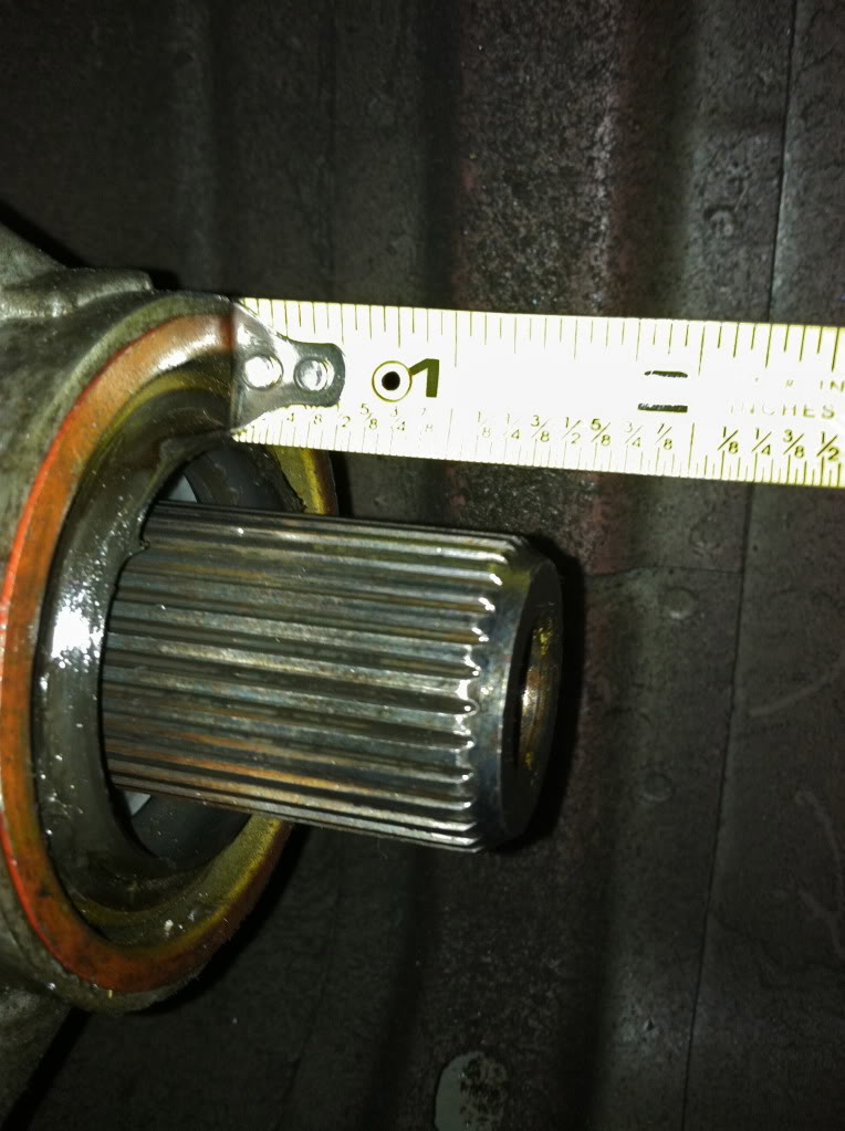

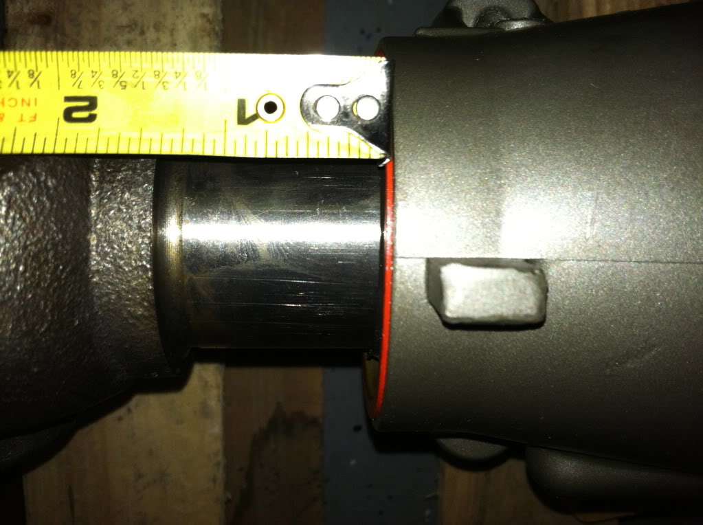

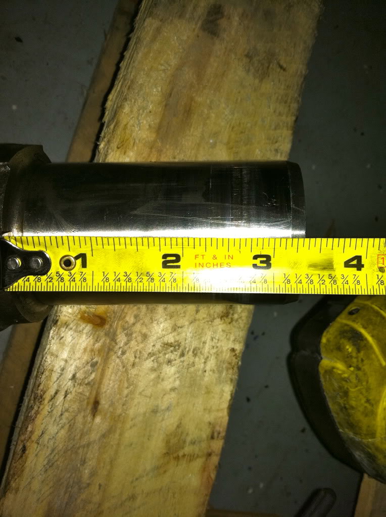

Looks like I got MotorHome operation. The current DS is cut so it Barely clears the rear to install. This is the numbers I got.
Current yoke has 3 3/8 spline area.
New trans Output Shaft extends 1/2 inch.
With Driveshaft Installed to wear line of old seal, it leave 1 3/8 remaining.
So that means I have 2.5inch of spine load.

Yep,
You got a motorhome output shaft installed in a 2wd unit. Mismatched parts.
I built a unit once with one of those shafts and didn't realize it as about an inch longer until I was installing the tailhousing and saw the shaft hanging out the back like your lower pic.
Pretty much the last part of the process of building the unit and had to completely tear it back down to change out the shaft.
It appears some builders don't mind sending out mismatched junk.
Your long yoke may work fine with the new trans. How much spine engagement does it have when all installed?
