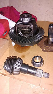

I used this exact same kit for the exact same reasons. It worked out great.
The cause of my whine/howl.
Mesh check.
New races:
New bearings:
Together with too much anaerobic sealant.
