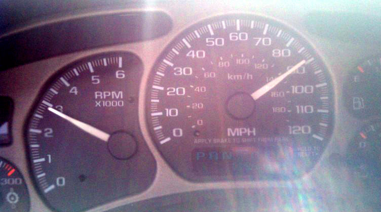

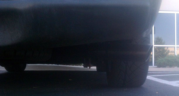

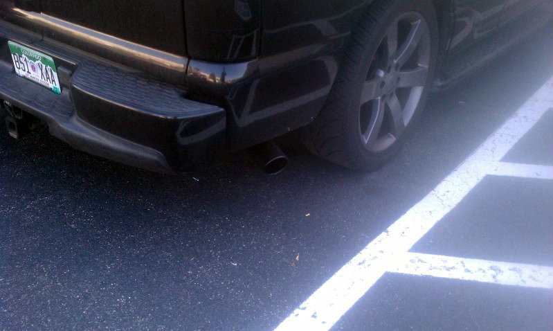

Was a bit on the fence about 4.10s or 4.56s so I decided to go a bit high and I'm very pleased with the result. Fresh bearings, seals, 4.56s, trutrac in the rear, and some new 3" mandrel exhaust with a black mbrp 4" tip

Waiting for break-in was painful, especially with all the hondas running around near my work, but I stayed out of the throttle and after a good 600 or so miles of driving like an old lady I finally got on it a bit. With a 31" tall tire and heavy *** 22s I think the 4.56s worked out perfect. Runs around 2300 rpm at 65 on the highway but holy crap did it wake up down low 1-2 shift occurs under 40mph and I'll be damned if 2nd gear isn't actually entertaining now. Really made the truck feel lighter and I barely lost any mileage, maybe 20-30 miles/tank but that may come back after another fluid change with synthetic. I know it sounds like a bit too much gear but with our altitude up here and the wheel/tire combo I'm really happy with the result, now I want a 3000 stall and a cam swap
