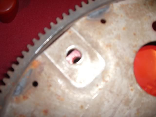

okay, TC showed up today. It has a 6 bolt flange. However, the pattern is a little smaller than a standard 6.0 flexplate.

when I PM'd Yank, they told me it was for an LS1 style flexplate, but that has the 3 bolt flange right?..hmm, I need to do a little more research I guess.
here's pics from the other member I bought it from.
