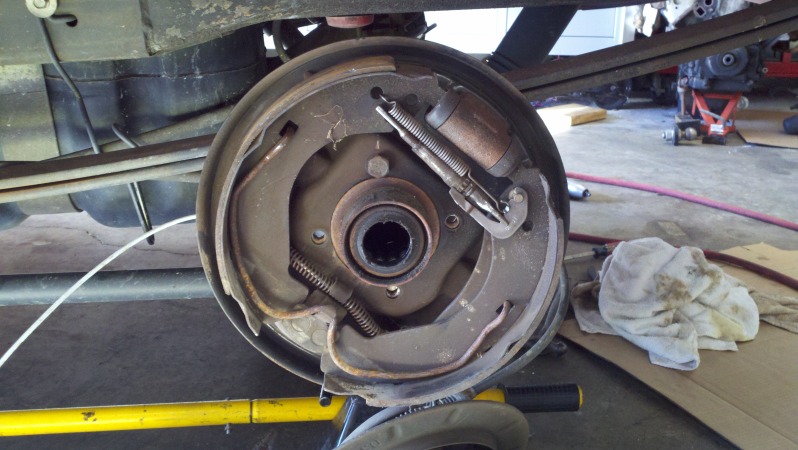

I pulled off the 2000 model disc set up and installed the 05 drum set up. It was a simple swap. I heard people had trouble bleeding this swap because of the new clockling of the backing plates so I hooked up the lines first and held them at 12 o'clock in my hands while I bleed them. Proceed to swap everything over and BAM! I got rear drums. I have hydro-boost so my new braking is still BETTER than the original vacuum/4 wheel disc set up! Not worried about holding boost at the line either.(transbrake) I am obviously thrilled with my results as I have tons of wheel options now. Hope this helps someone .

Nothing but good things to say after driving it some . Plenty of stopping power. Now i have room for the wheels I have wanted for years!
