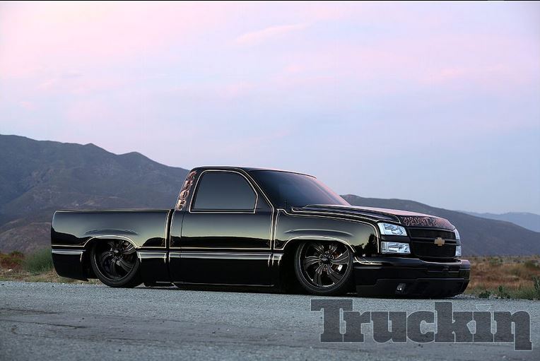

Originally Posted by KevinF56
I have never seen or heard of it done and probably for good reason. It would look goofy as hell.
I have seen the super-short beds from crew cabs put on a regular cab, but that doesn't move the wheel base, only shortens up the end of the bed even more.
The distance from the rear of the cab to the wheel center is different on the nnbs 5.5' crew cab bed and the 6.5' reg and ext cab beds. It will shorten the wheel base.
Old Apr 26, 2014 | 09:01 AM
KevinF56's Avatar
Joined: Aug 2006
Posts: 1,726
From: North of Boston
I guess you're right. For some reason I thought it didn't move the axle forward but it looks like it does:
