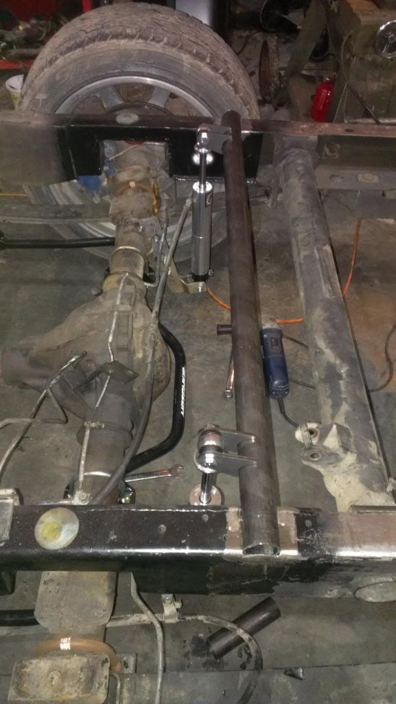

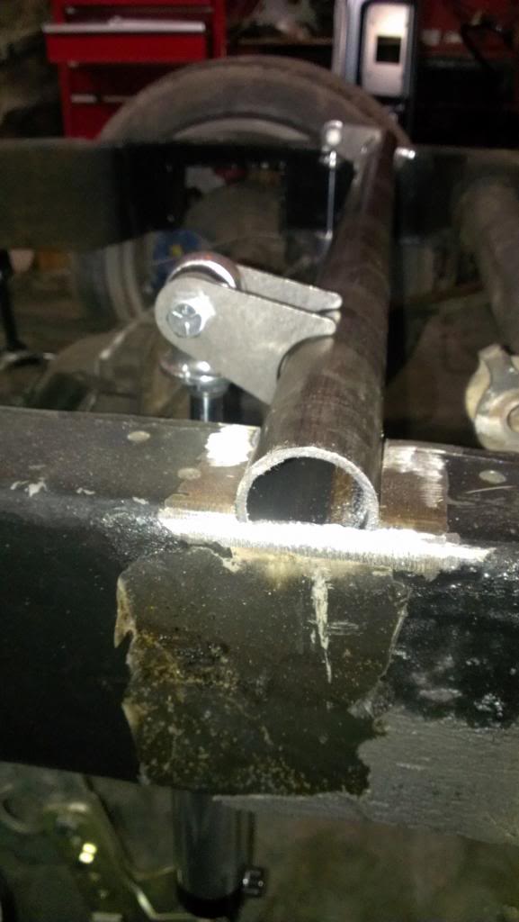

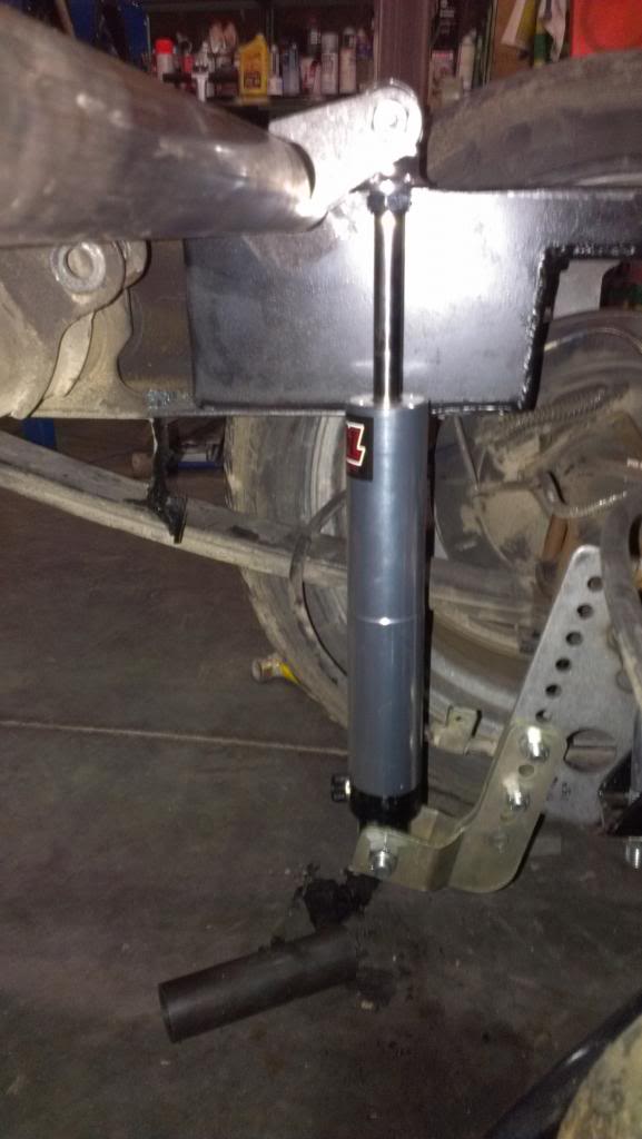

Default Critique my shock relocation
Moved shocks behind axle. Lemme know if you guys see anything that needs to be addressed before I burn it everything in. Crossmember is 1 3/4 D.O.M, all fastner's are fine thread with ny-locks. Shocks are laid back 1-2*
