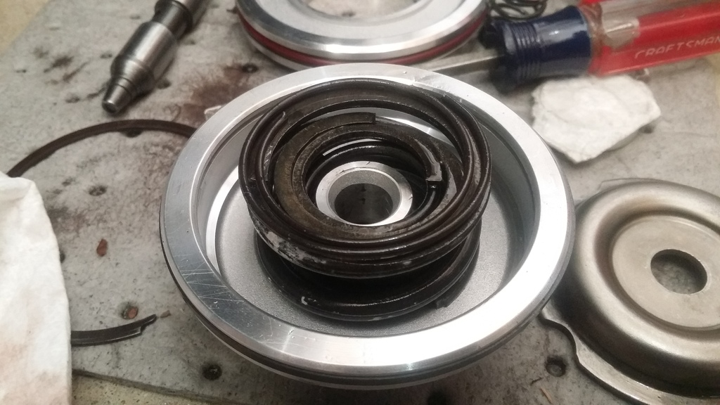

1. when I disassembled my servo and compressed it to remove the spring. I don't have one spring inside like the others. I have what looks like 3 springs, springpack.
2. In between the two packs I have a brass in color washer.

Springs in question
There's actually 3 springs and a coil on top of the springs

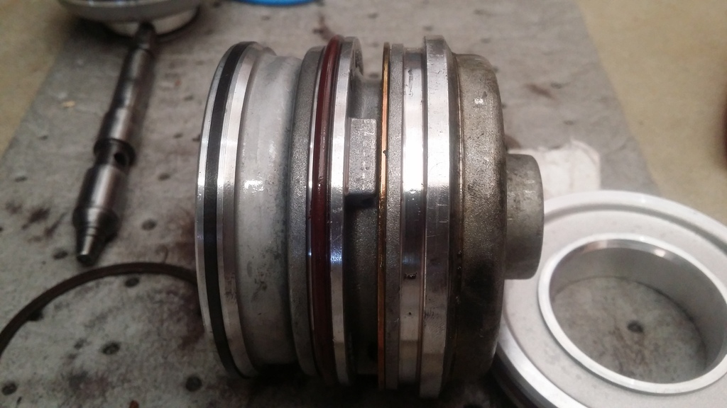

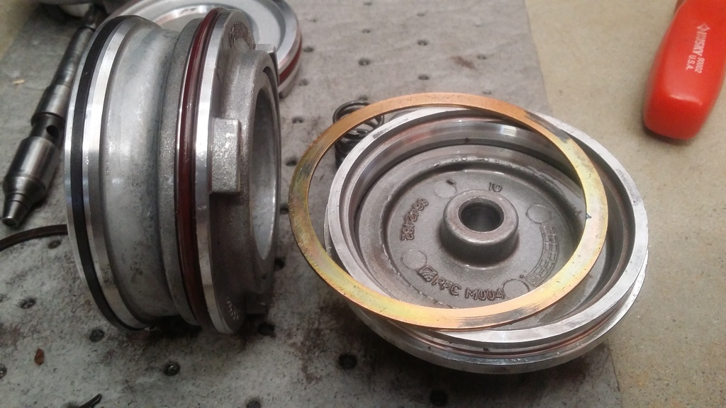

washer
assembled to see where washer was

I removed the washer, which in turn is a spacer for shift firmness that I found in the 3 hour ordeal this took, haha.
After removing it I was able to get the correct 1/8" of movement out of it. Took it for a ride and it shifts nice into 2nd at speeds. I'll get a better feel after I drive it for a little while.

That may be what the bronze washer and extra springs are from
