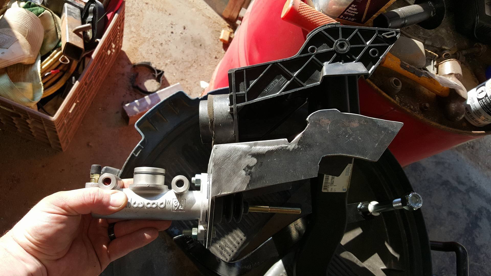

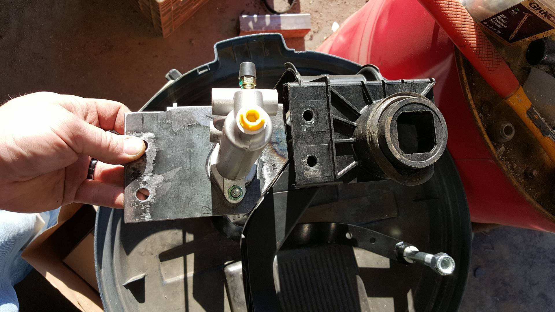

I had that same thought. I built my own out of 3/16" plate steel, a wilwood master, a heavily modified 1967 camaro clutch pedal, and some micro switches. It was WELL Worth doing it, and I would easily pay $200-$300 for this setup.
