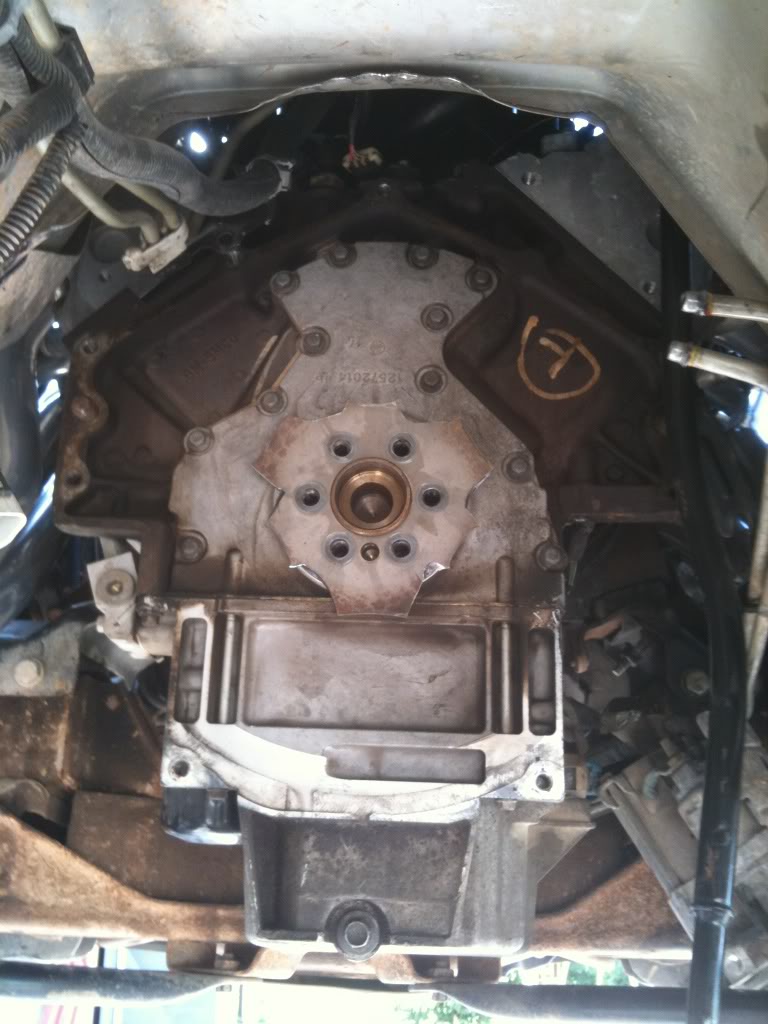

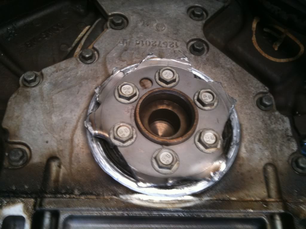

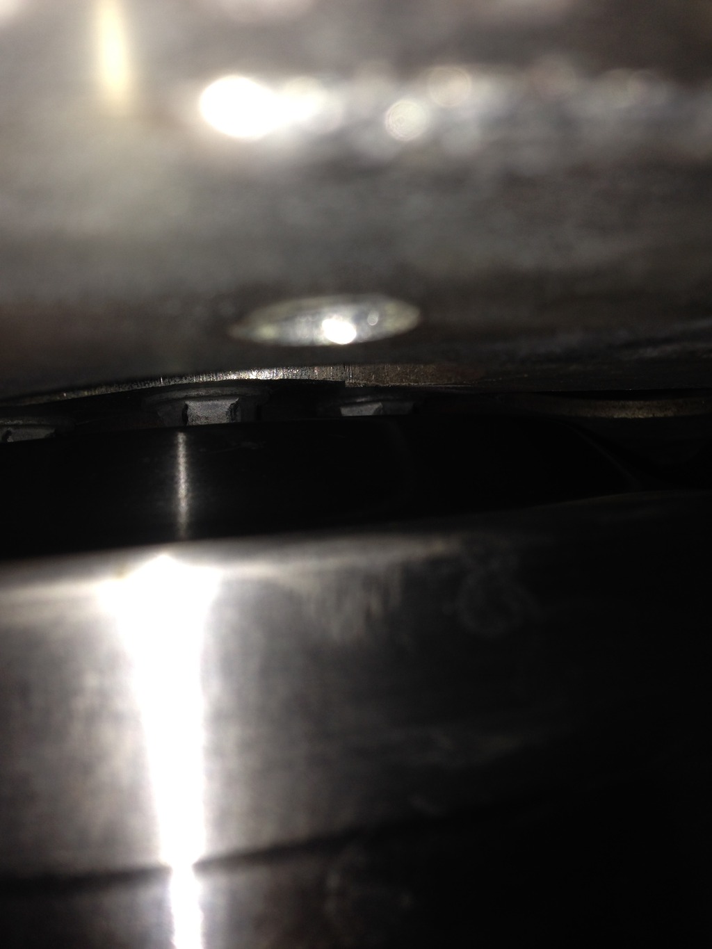

[QUOTE=brandon6.0;5285802]Do u have any type of vibrations? When your breaking the flexplates what is happening? Stress crack around inside bolt pattern

It's cracking around the bolts

Well hell you did a good job on that one haha

Yea ive never seen one broke like that. Usually its cracked and just rattles around. That one looked to be a stocker that broke off completely. Damn. What about a bad harmonic balance? Could that be a possibility.
Thats definately a wierd situation u got there.
