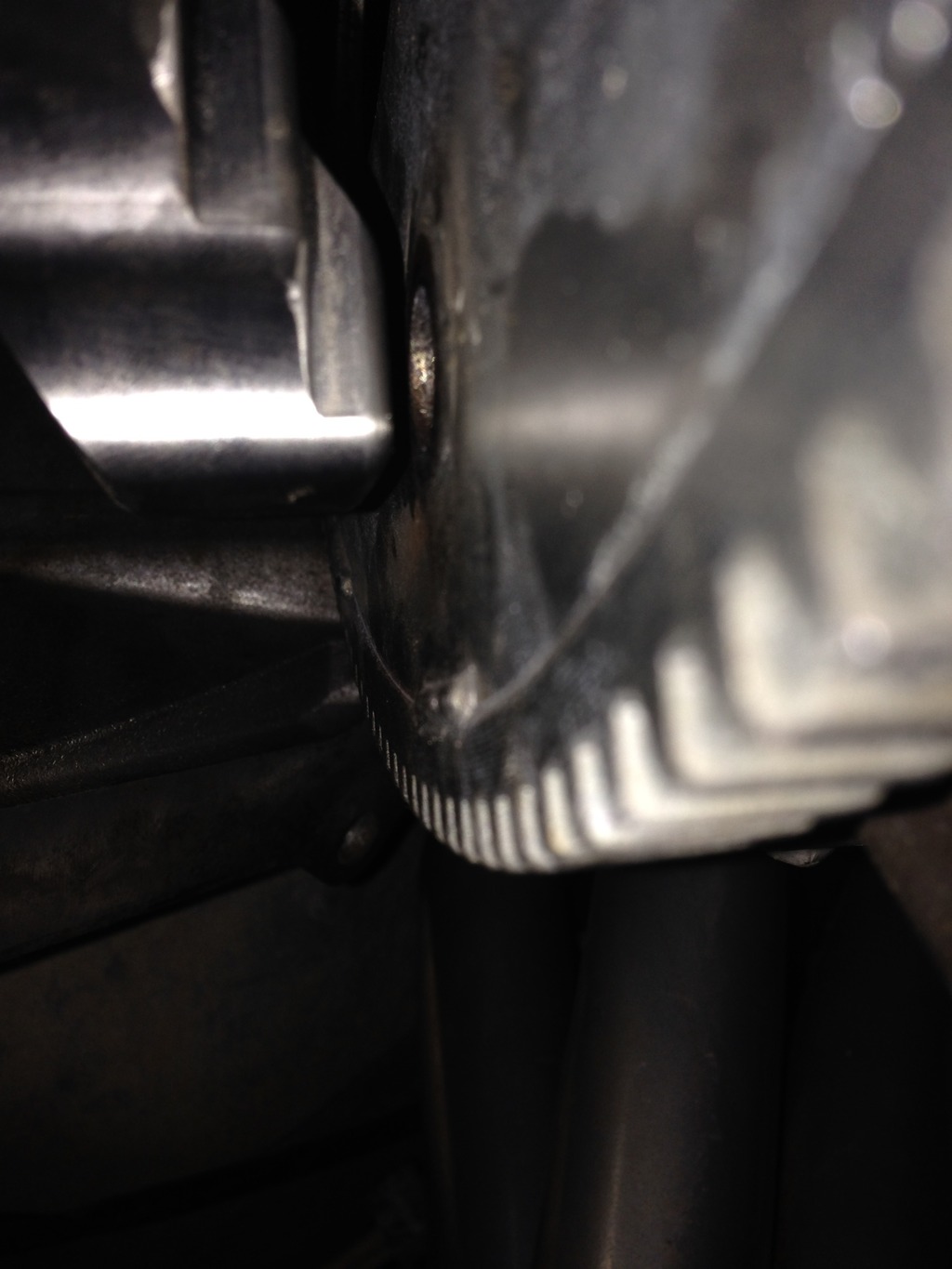

Cardboard measures 1/8 so if slids in no shims needed.
Old Apr 13, 2015 | 09:24 PM
  #26
GMCtrk's Avatar
iTrader: (27)
Posts: 12,275
Likes: 19
From: Dallas
That spacing looks good. Looks like you paid good attention to detail on the install so I'm going to assume the converter was appropriately fully seated on the input shaft.
