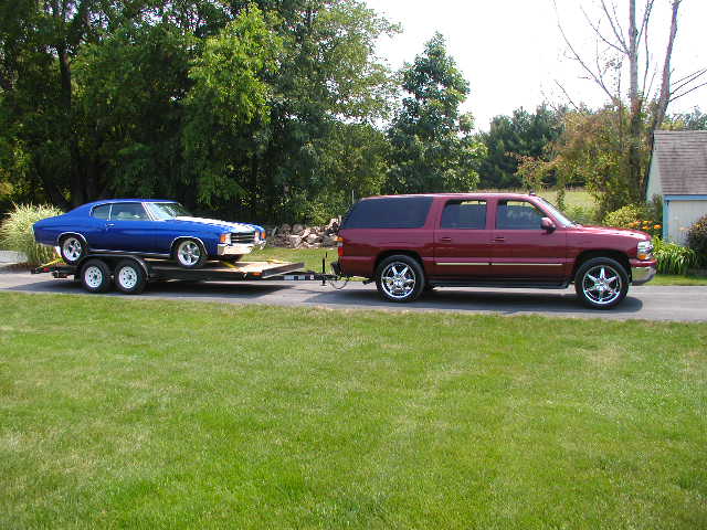

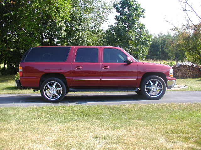

no drop on my suburban yet but i wam going to be going with spindles in front and bags in the rear to help with towing.. Also i have 305/45/22's so you can get an idea fo tire sizes.. rides like a dream
