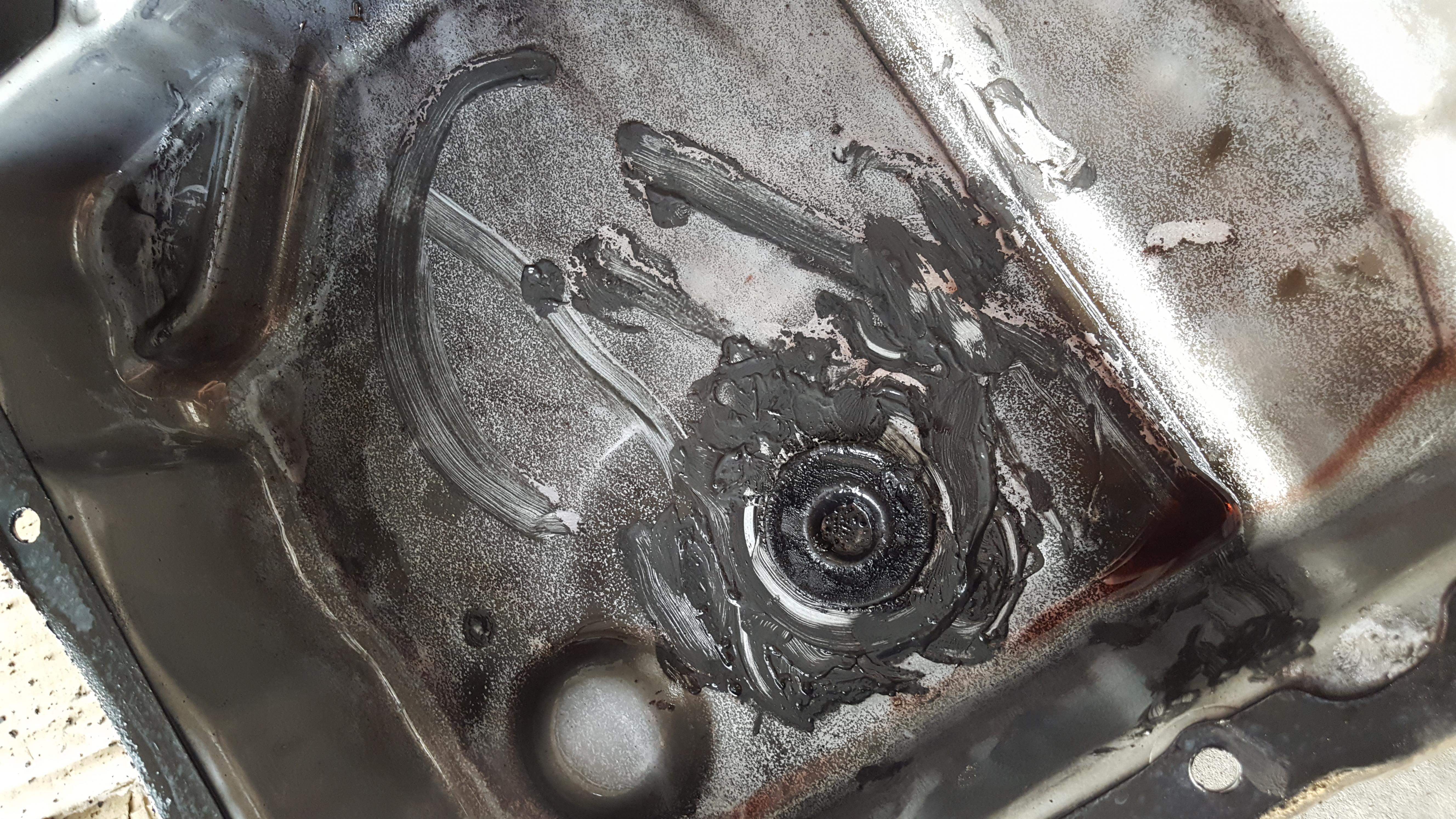

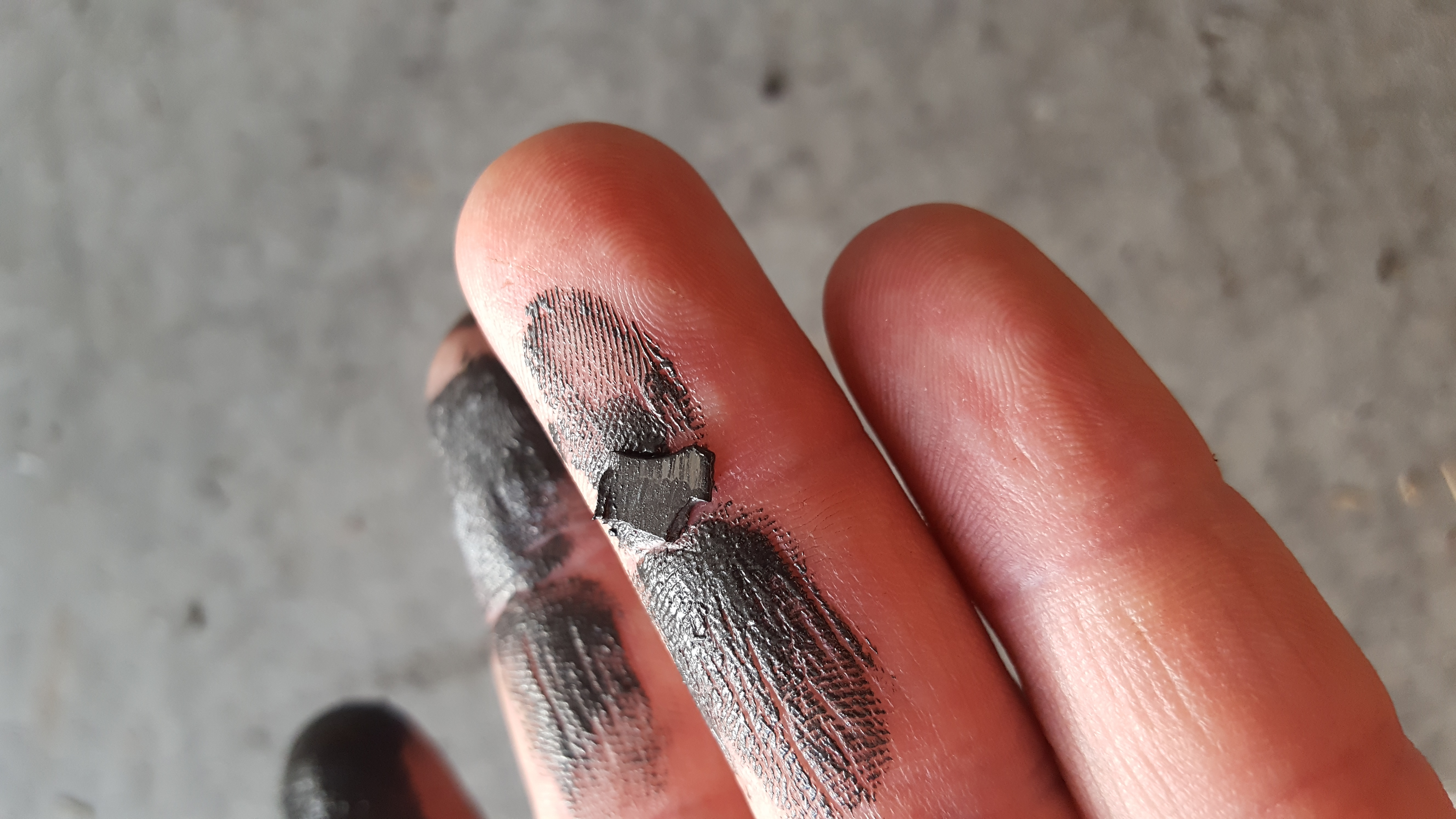

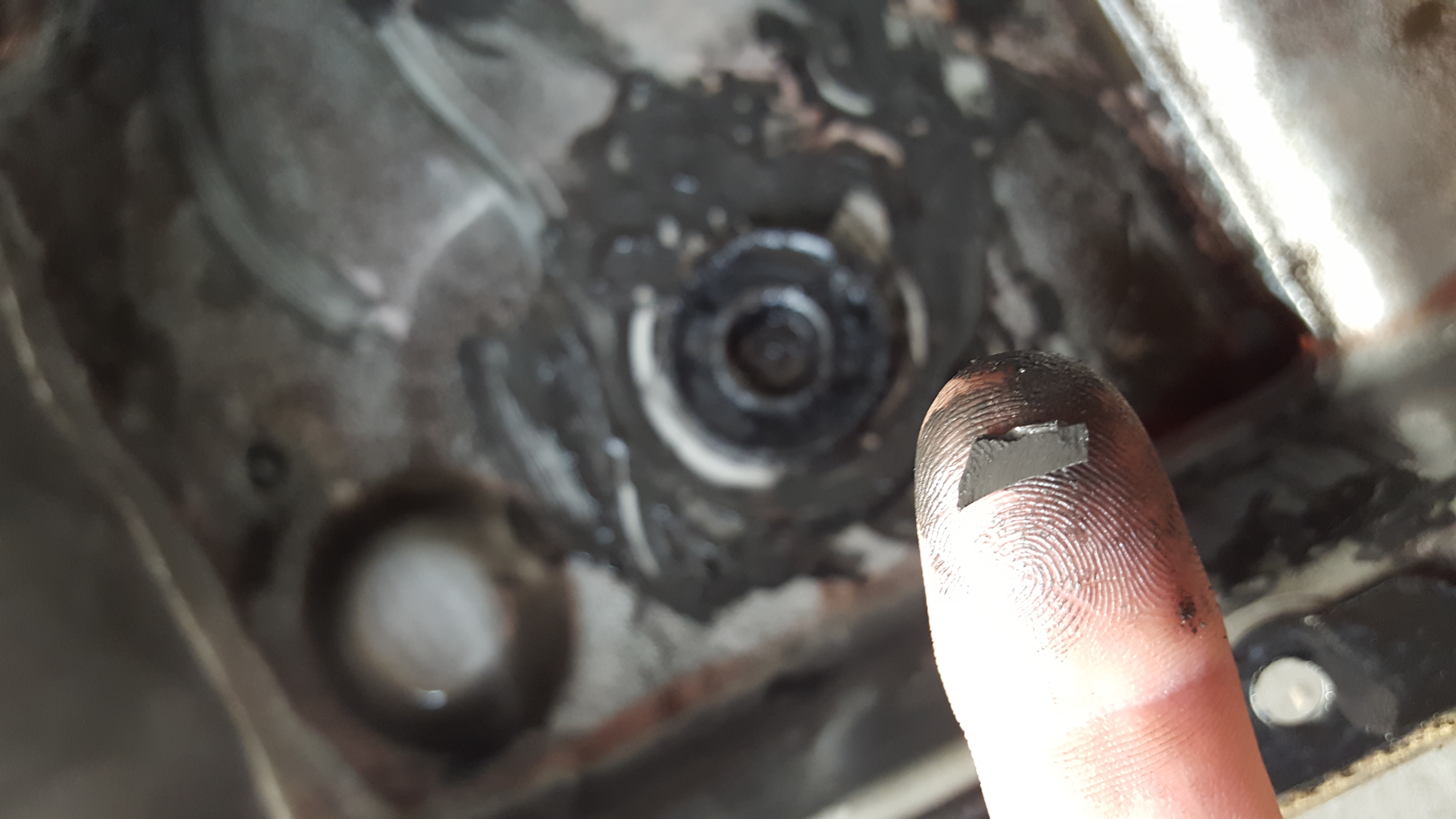

I came across a 05 60e that is said to have 73k.. so i took the pan off to do some up grades before installing it in my 00 hoe. I found this in the pan...i know some gray sludge is common but it was about 3/8" (guess).build up on magnet and a few small metel pieces (picture)on magnet. I assume it is a piece of clutch material?
I don't know enough about these to make decisions...install or bring back?

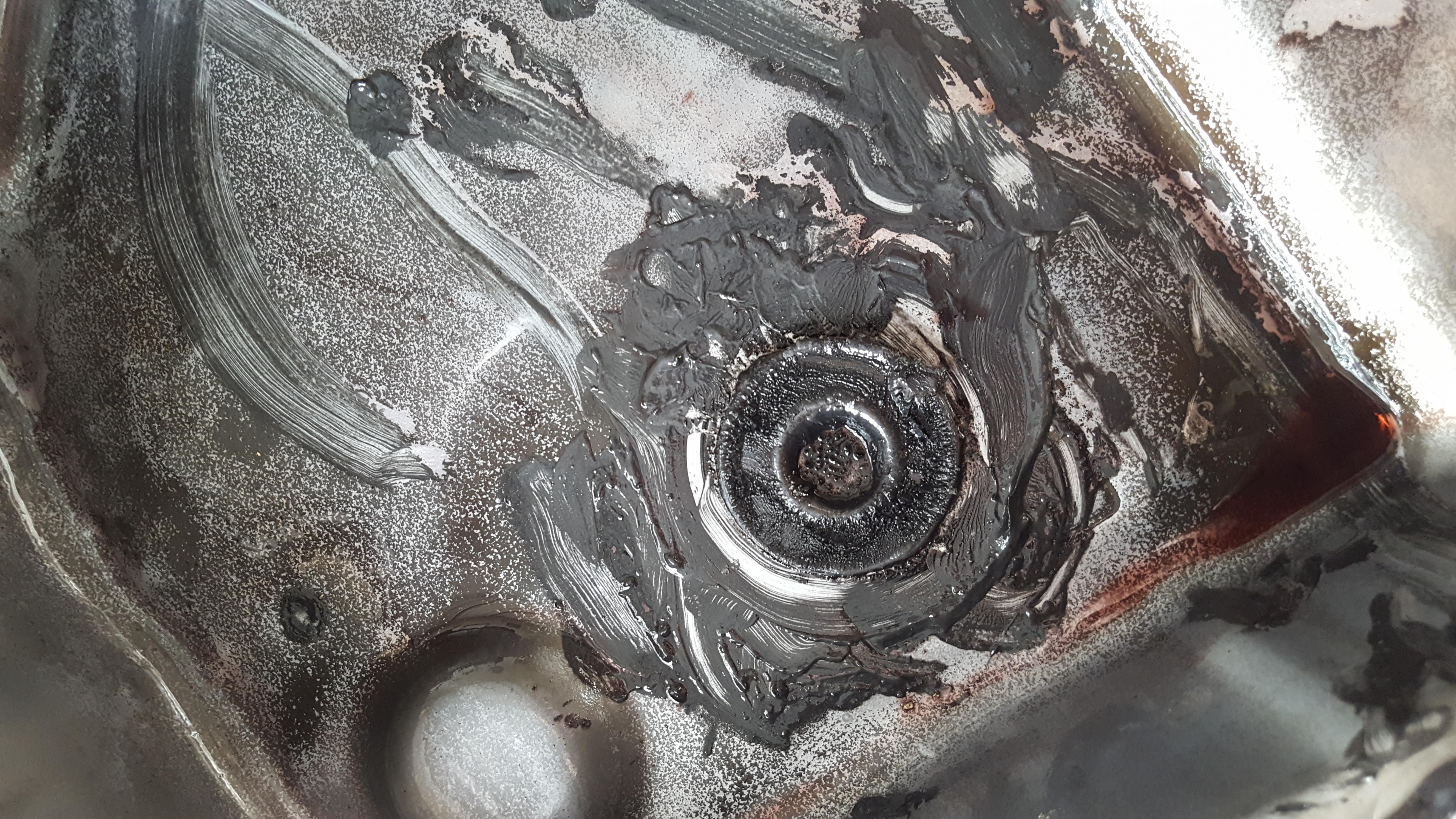

Another picture of a piece

Stuff it in should be fine if you believe the guy was honest with 70k mi

Guy sounds straight up.New filter of course,number 1 thing people F-up is the converter isnt all the way in when bolting it up.Have you pulled the old one out yet?

You get it for decent price ? what up grades you mentioned? its a fair amount of shitin the pan,seen worse but I would run it.The guy claims it worked excellent right?
