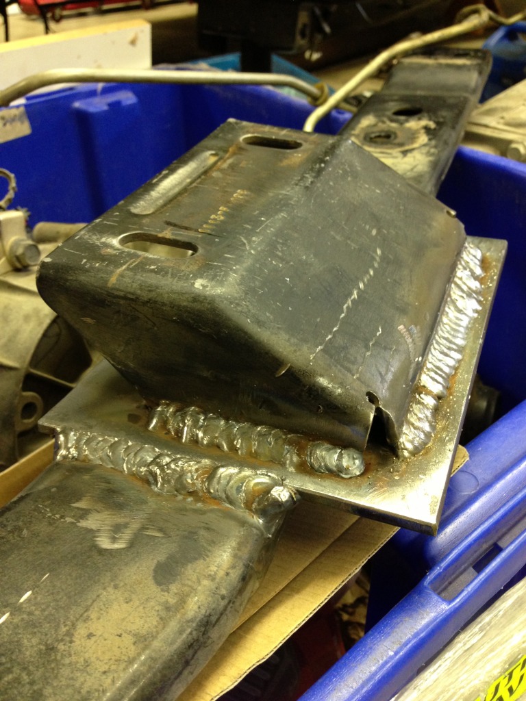

Fugly flux-core wire...

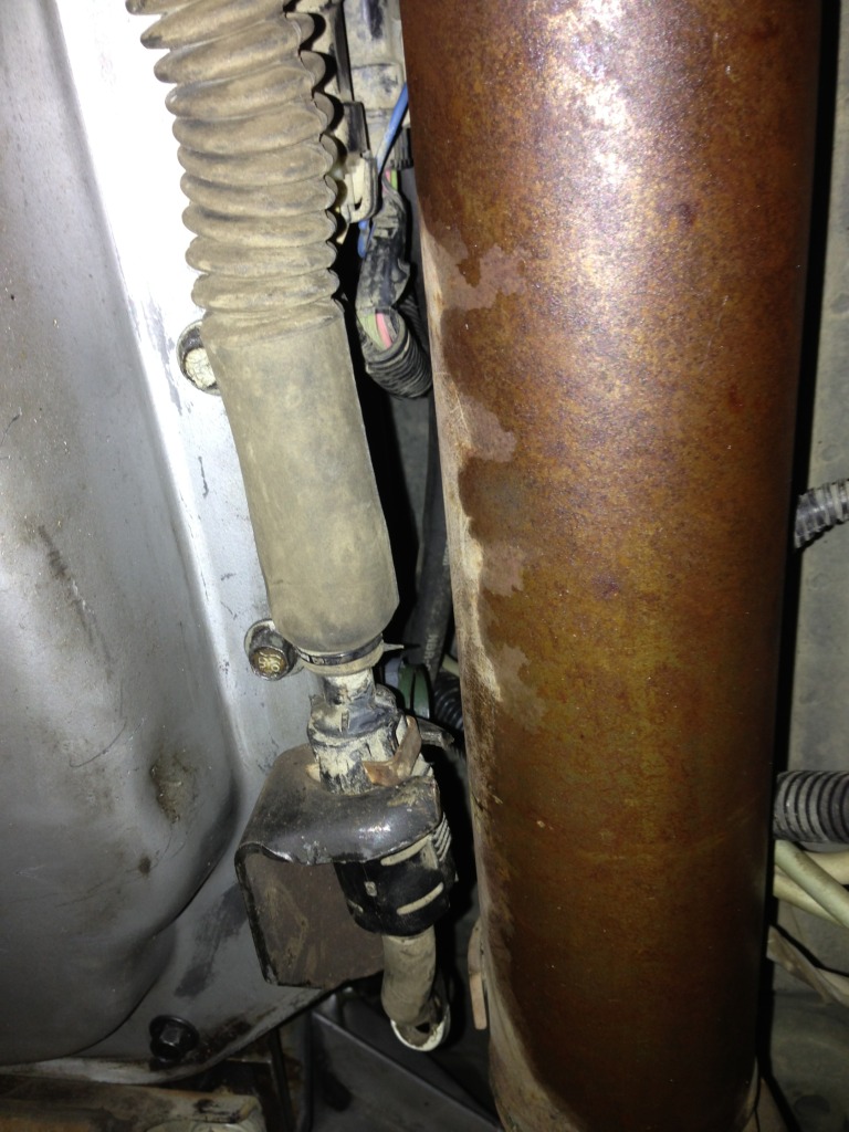

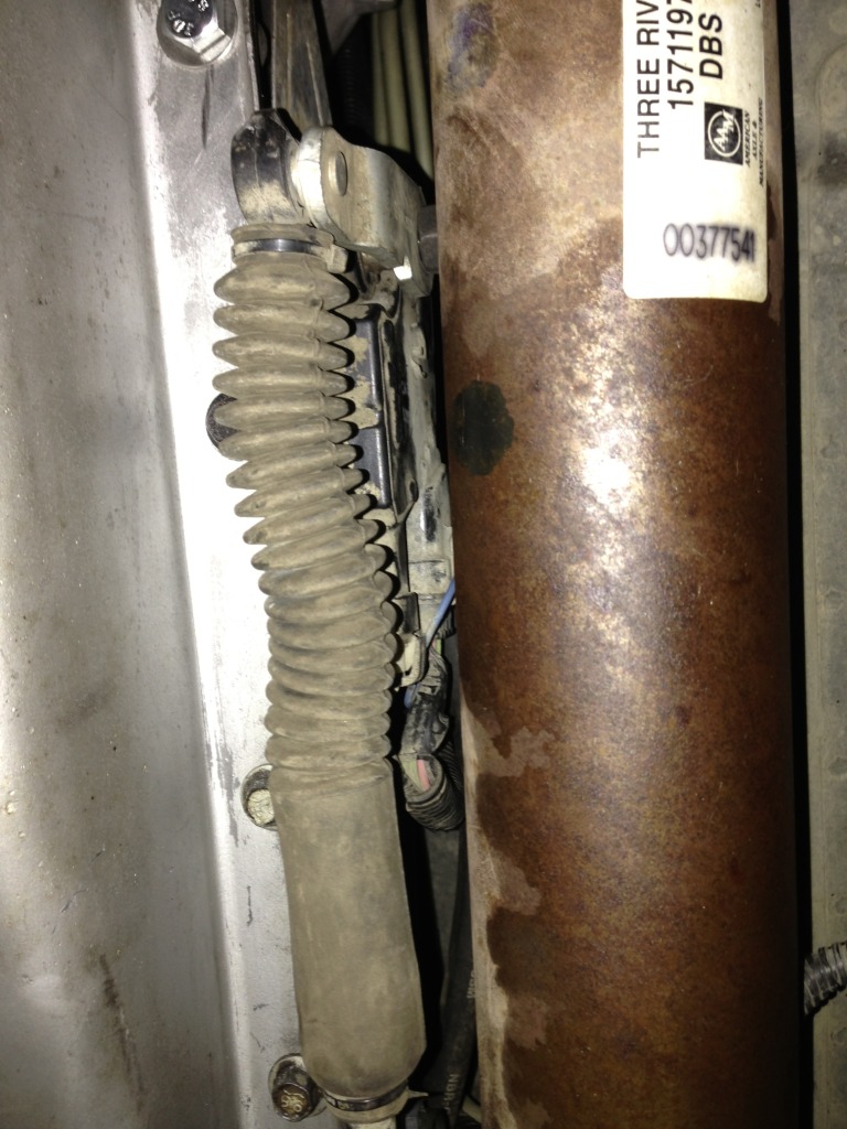

I just finished my 80E and 149 swap. I reused my front driveshaft. It's close though.
