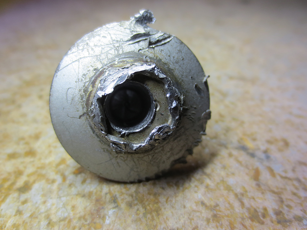

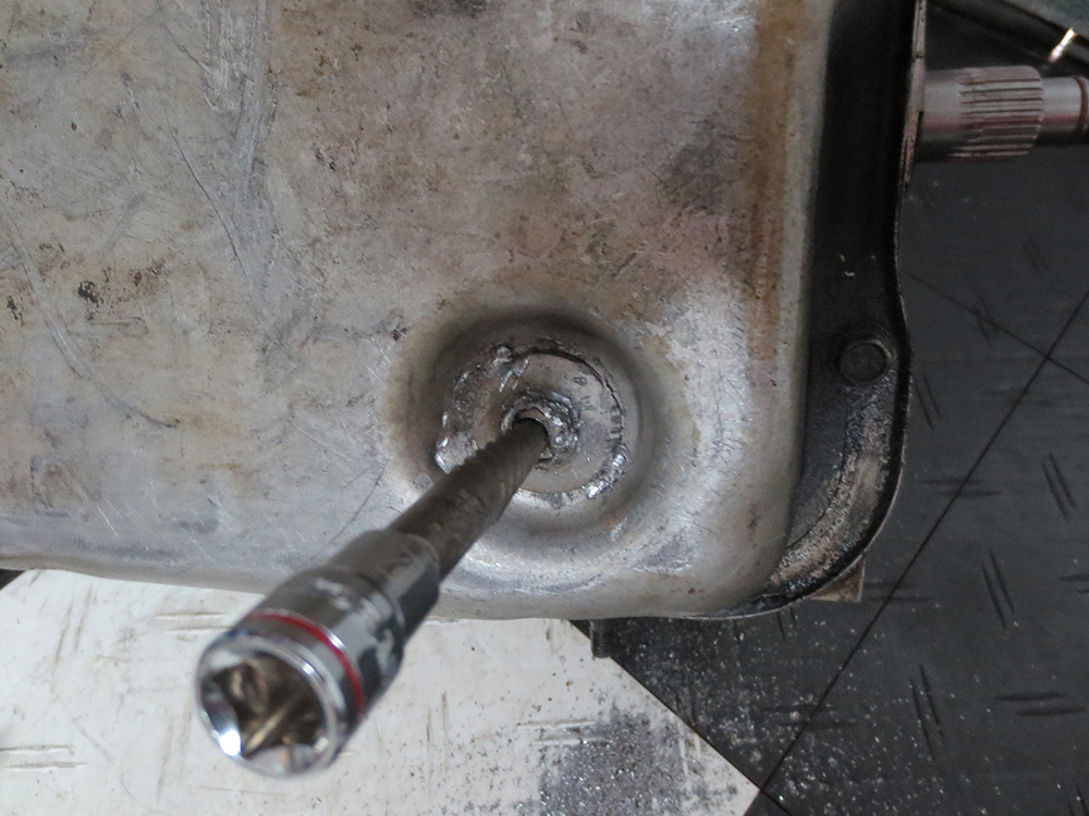

Those transmission drain plugs are soft, shallow and get rounded off quick even with a tight fit 6pt socket.
easy out = no go

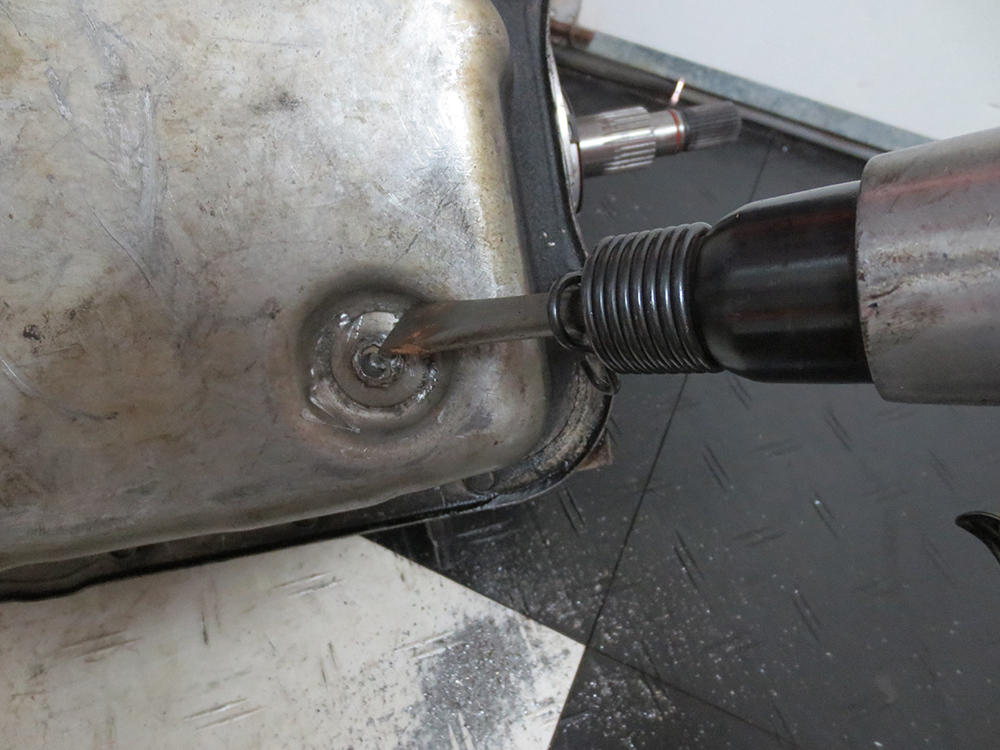

air chisel did the trick

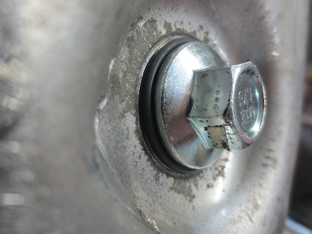

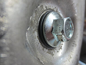

$6 dollar Autozone universal drain plug with a deep hex much better than GM's... very rare Autozone beats GM
