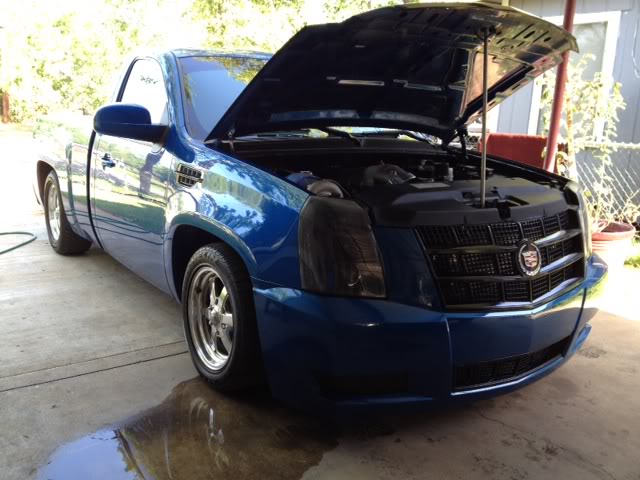

ok so heres my problem..2008 Silverado with intercooler.....so recently i had the cooler mounted like this behind bumper,has a lil grill opening for air
highway its perfect at 140-160 temps...once im at a stop or light rises to 180+
now you boosted guys with tru coolers...where do u have yours mounted with the intercooler in the grill?
heres the way im thinking of doing it...
what do yall think? you guys that run it like this in front of intercooler,did it affect AIT's? i might try and make it fit behind the intercooler.idk i just need to get rid of that heating up bs at idle....when i had the 6spd it hit 245 just waiting in line to race

I have mine behind my intercooler, but I would try a fan on.yours where it is to see if that helps

a bunch of people have them behind the intercooler, what temps do they see there? i could see that making the temps rise a bit, i would think where you have it is a decent location.

if the truck has e-fans, it should be more efficient to mount it up top where the fans can pull air through it while you're stopped. it would still work well while your moving.
the lower location only cools the trans while your moving.

Yea I'm going to mount it up top since it has more grill ( air space)then I'll see how she acts
And yes truck has oem e fans
