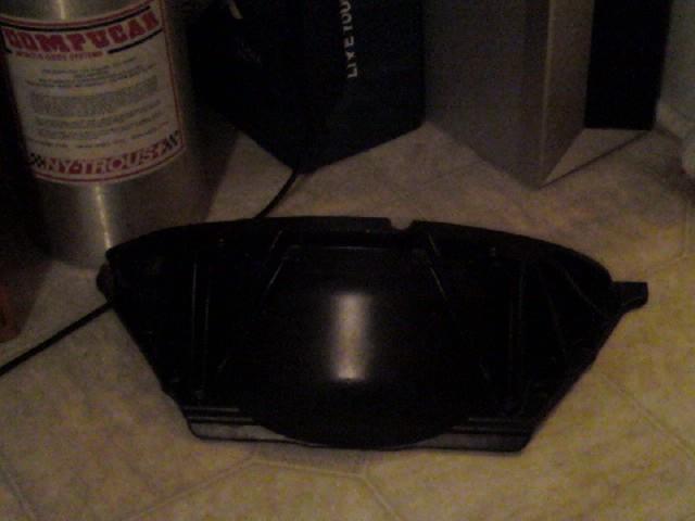

this is the one for the 2wd . dont get this one either.
