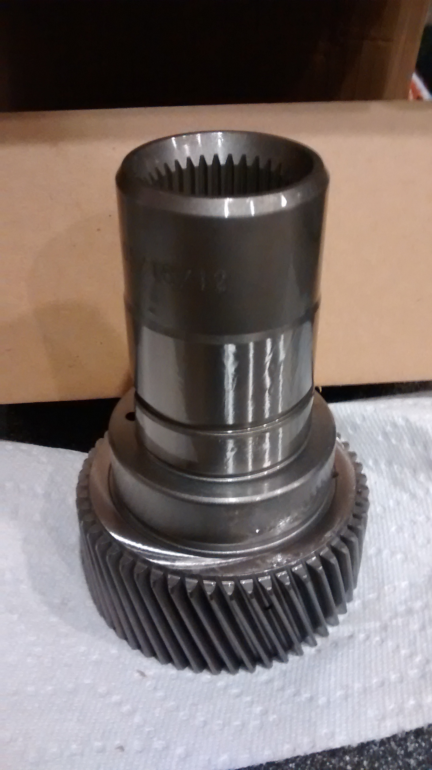

32 spline input shaft Part number 19019 for transfer case.

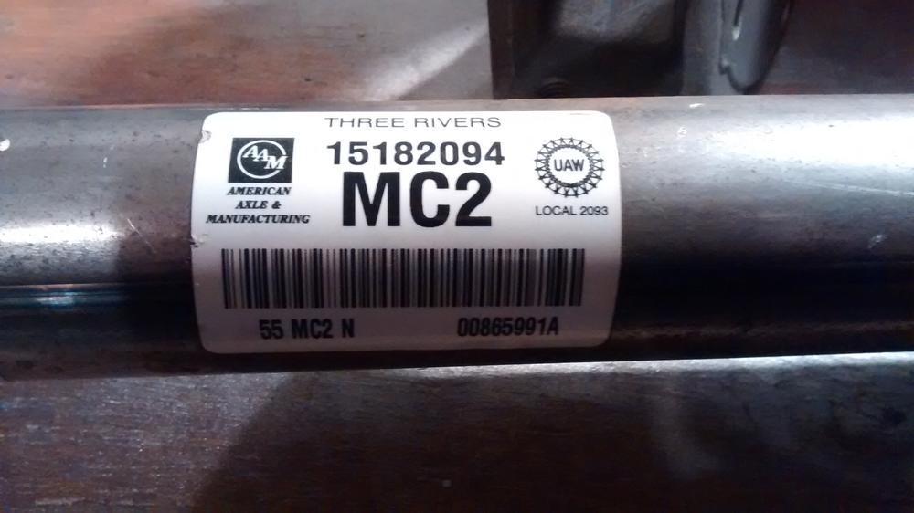

HD truck front driveshaft.

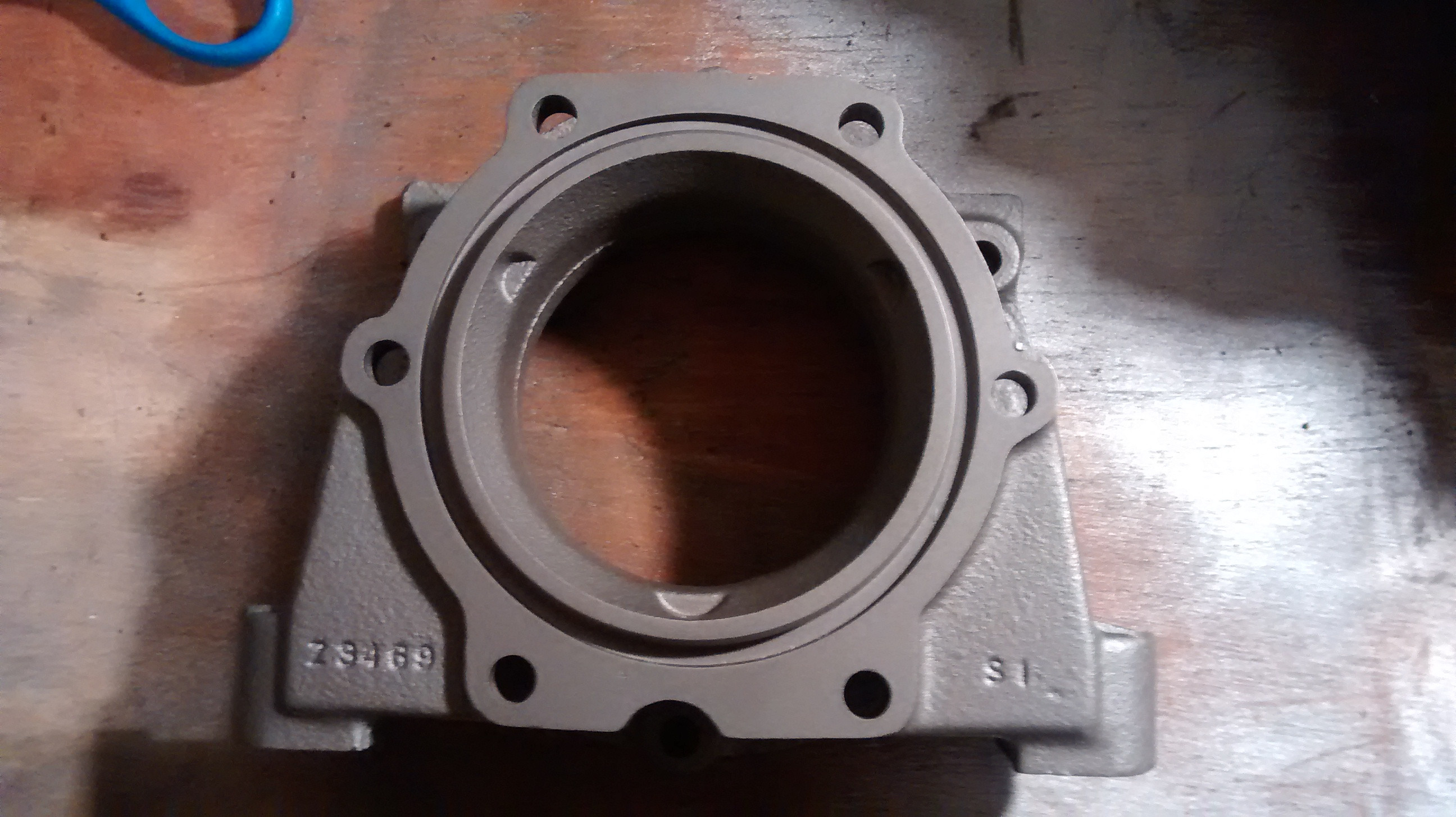

If you don't have a 4wd trans you need this adapter:

Yeah, just the 32 spline

like mentioned you will need a 32 spline input shaft for the tcase along with the tail housing adaptor.
my local trans shop had both of the items in stock and cheap

You will also need a pilot bearing to install into the new 32 spline input gear.
