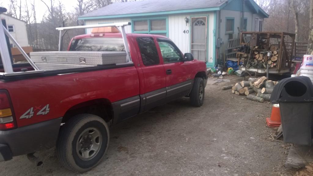

Looking at the pics of the truck it looks like a semi floater to me. I know I need a semi float not a full. All I see in the pic of the truck is an axle poking through the wheel. No hub with a ring of bolts like a full float rear.

o1 HD is a 10.5 FF
now a 01 2500 LD could possibly a SF but ive never seen one

I could be mistaken but when I zoom in I don't see any evidence of a full float hub.
A friend of mine has a 2000 2500 that has a semi float 14 bolt in it as well. Unless these are both 2500 ld? His has no badges and the one I'm going to grab next week I haven't personally laid eyes on yet. Just waiting till the guys new truck shows up and I'm going to get the one in the pic

The one in that truck is 14 bolt SF 9.5. It is also a regular 2500 model truck.
You would have to tell us the year when you get it. But I am willing to bet it's a 2000 model. If it is a 2001 it is just a regular 2500 but Like ScreamingL, I have never seen one either.
