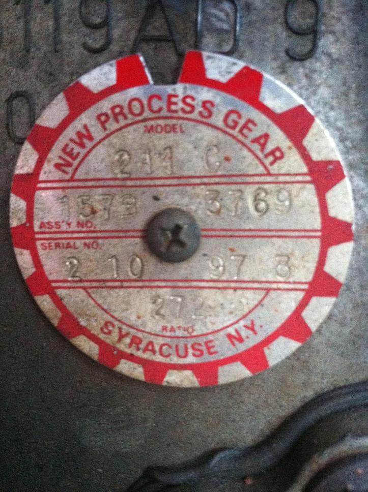

I can't find any info on the 244C that came on the 80e, can it be used or do I need to use the 246GM that is on the 60e I'm taking out. if i can't where the best place to get what i need to make the 246GM work on the 80e?
I think I have most of the other stuff figured out. I'm looking for the -6 trans fitting for the 80e and going off a list in the tru cool thread on braided line stuff. any help or tips would be great.

maybe you can just swap your encoder motor over to the new xcase?
if you have the Auto 4wd... thats the autotrack.
search for 4l60e cooler line AN adapters..

or just swap the input gear in the 60E xcase and give me the 244c

the 241C will be on the market soon.
I'm guessing from the numbers the 80e is from the early yrs (1997). So i'm guessing this will bolt up and work. I'm going to get the 32 spline input for my 246 and go from there. so should I see any problems from the 97 80e?
