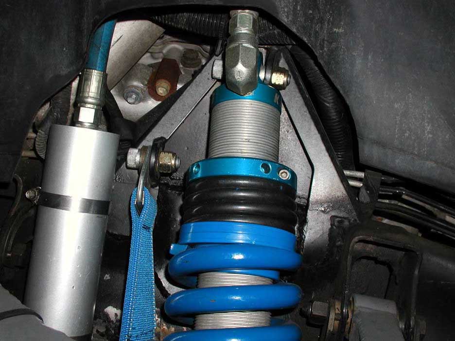

Here's a pic of a truck I rode with the conversion and it rode like a dream. King coil-overs with remote res.
Half shaft clereance wasn't a problem.
Chris

It looks like it has a lot of negative camber in that pic, but it could just be an optical illusion. That is a cool looking conversion though. Got anymore pics? IF you ask on www.offroad-tech.com/forum about finding the coil rates, you should be able to get some help from Darketernal or Willyswanter. HTH

Thanks for the replies. I think the camber is just an illusion. The guy that owns the truck is working on getting me some more pics. The company that did the conversion for him is out of business now, typical great builders just bad businessmen. That truck also has a linked rear end with airbags and shocks connected about half way up the lower link kinda like a trophy truck, it rides like a Cadi on and off-road. I'll post the pics when I get them.

here's some more pics of the truck with the conversion sone already. Looks like they modified the lower a-atms and moved/gusseted the shock attachment, might have to get some welding help on that one. Last time I tried to weld on something cast, it didn't go well. Looking at the pics some more it doesn't look like it's going to be all that hard, just need to make sure I get the geometry and spring rates right. I'm sure there will be something that will go wrong but hell that's the fun part.

That looks pretty cool. If you notice, it appears they cut off the upper stop on the uca, thats why they have the bumpstop. If you're going all out, I'd get a custom lca fabbed up. The uca they used in that kit looks cool, but I prefer tubular arms more. Good luck on your project and definitely keep us informed!
