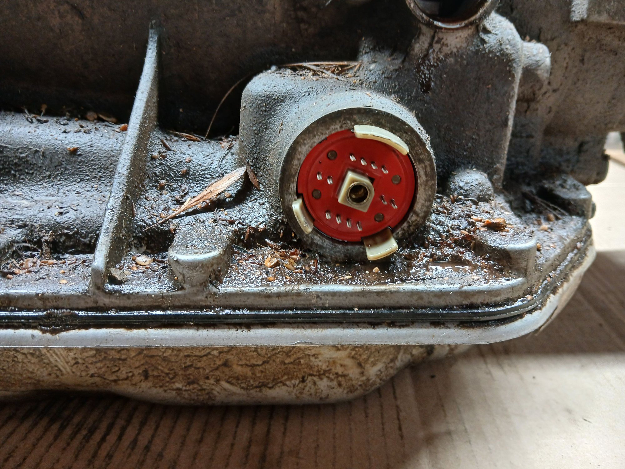

Originally Posted by brian12321
I have old style on a '92. External wires are old and exposed wires..Can I replace the external harness with the new style only, or do I also need to replace the internal harness?
If it looks like this yes you will have to replace the transmision harness. In the middle of this literally as we speak and need to get it finished by Wednesday along with a rebuild/reinstall.
