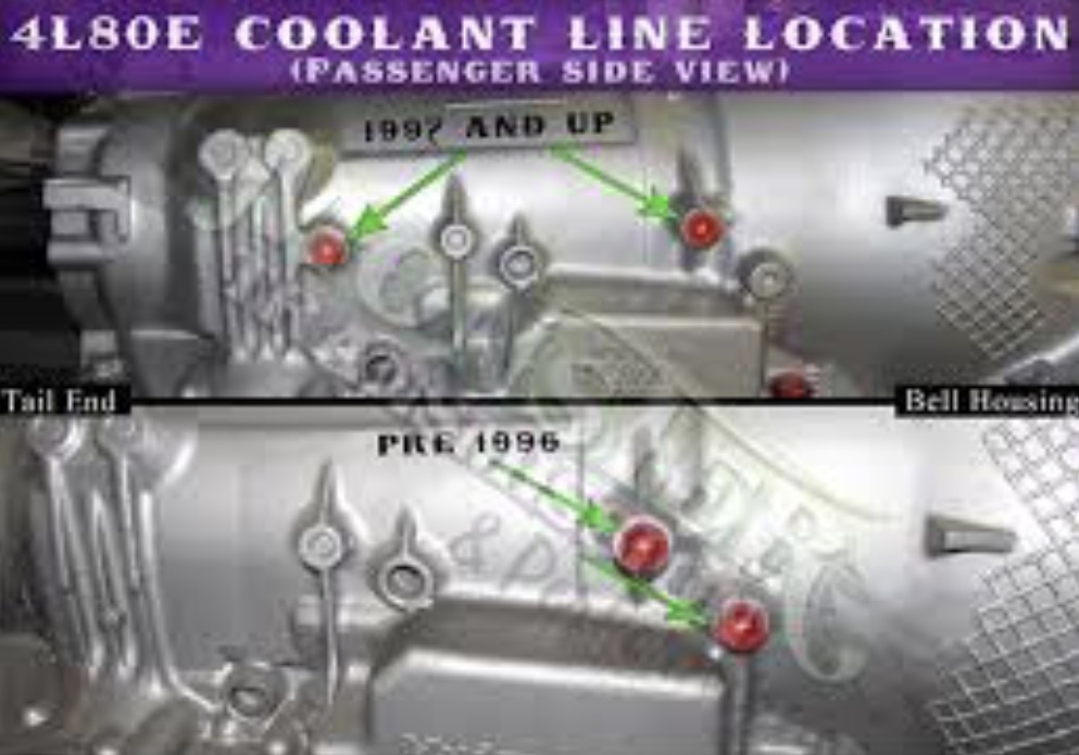

LMAO
this is more of a reference for me...it might save someone else a search.
