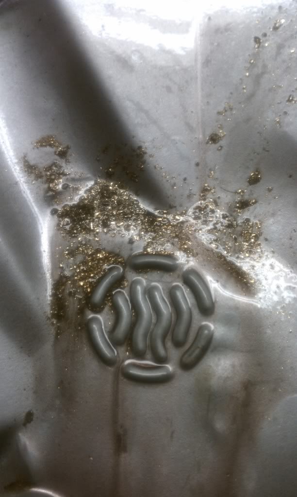

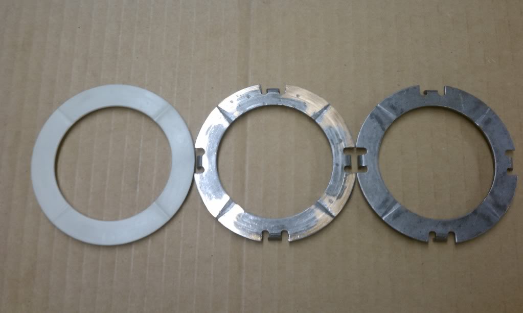

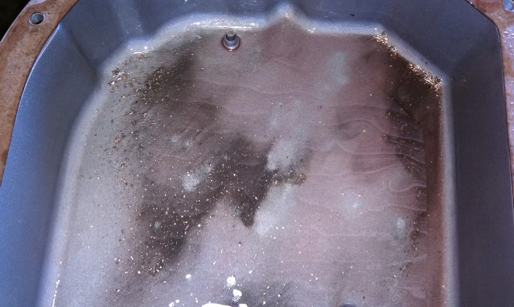

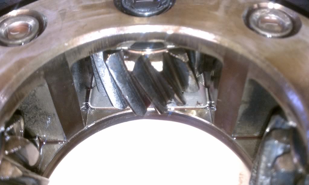

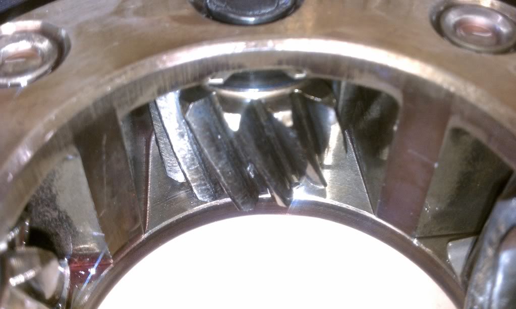

I would strongly suggest that you repair the tranny. I had this happen, and posted the pic of the different nipple. That nipple off of the fitting goes into the center support, and sends lubrication and coolant to the rear of the tranny. It will take out a planet gear shim in no time. Note the shim in the first pic, and gone in the 2nd. I found part of it in the 3rd pic. Most of that material is from the bushing between the planets. It also beats the snot out of the bushing between the planets #238. If you just run it that way, all of that debris is floating around in your tranny. It will go through your cooler, lines, clutches, and converter. It is basically like sand going through your tranny. When I bought this tranny it did not have the fitting, and I never knew the difference since this was my first tranny rebuild. I ended up getting a core tranny to compare parts to find out the problem, and thats when I found the fitting to be different.
