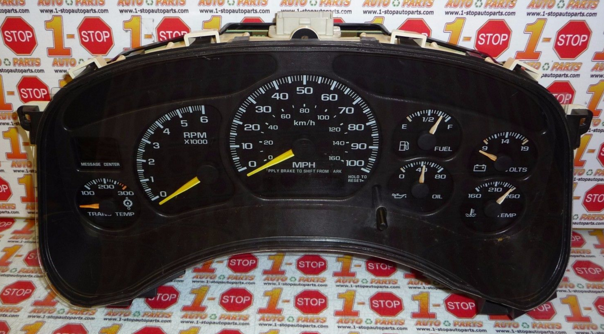

Do y'all run a trans temp gauge in the cab? If so, how?
My factory cluster has one, that and I log it with HPT.
Hmm, OK. I'll had that pid to my hpt logger and see my aftermarket options, back on topic, sorry!

Originally Posted by GREENSIERRA
I run a auto meter trans temp gauge. I welded a bung into the pan for the sensor.
been running it for 9 years or so and couldn't live without it
Good idea. I'm taking the easy way out.
