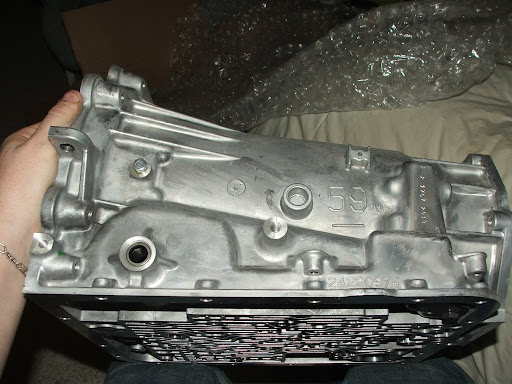

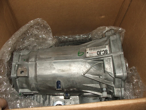

Brand new 4L65E center case. Just want to make sure that I don't have any issues with the core case I have right now.
enjoy
