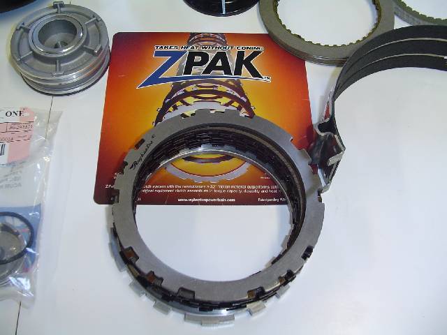

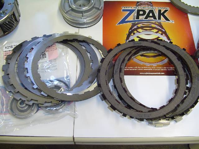

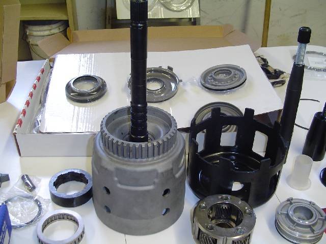

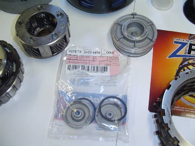

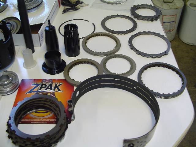

I have been collecting parts and tools for the last month or more, getting ready to build up my 4L60E. I plan to do the rebuild next weekend.
The parts include
- Torque drive system - Hardened input shaft and drum, hardened beast sun shell.
- 5 pinion front and rear planets
- 29 element double caged sparge
- Z-pak 3-4 clutch - 14 one sided clutches
- Raybestos Pro Series band
- Corvette servo
- Alto master kit
- Transgo stage II shift kit
- High output pump slide spring
- 13 vane rotor kit
- Aluminum accumulator pistions

I believe the 99 up 4L60E comes OE with 13 vane pump rotor.Let us know when you get into it.
Old May 23, 2005 | 08:20 PM
Black02Z71's Avatar
Joined: Mar 2004
Posts: 361
From: Ontario, Canada
Originally Posted by gonzo 6.0
Black02Z71
yea I think its 1997 up, I found out after I bought the parts, it was only $45 for the whole pump kit.
