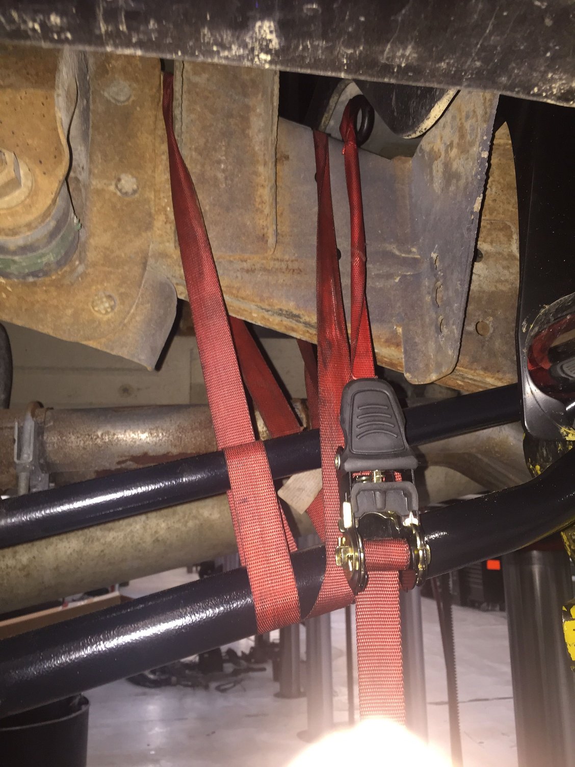

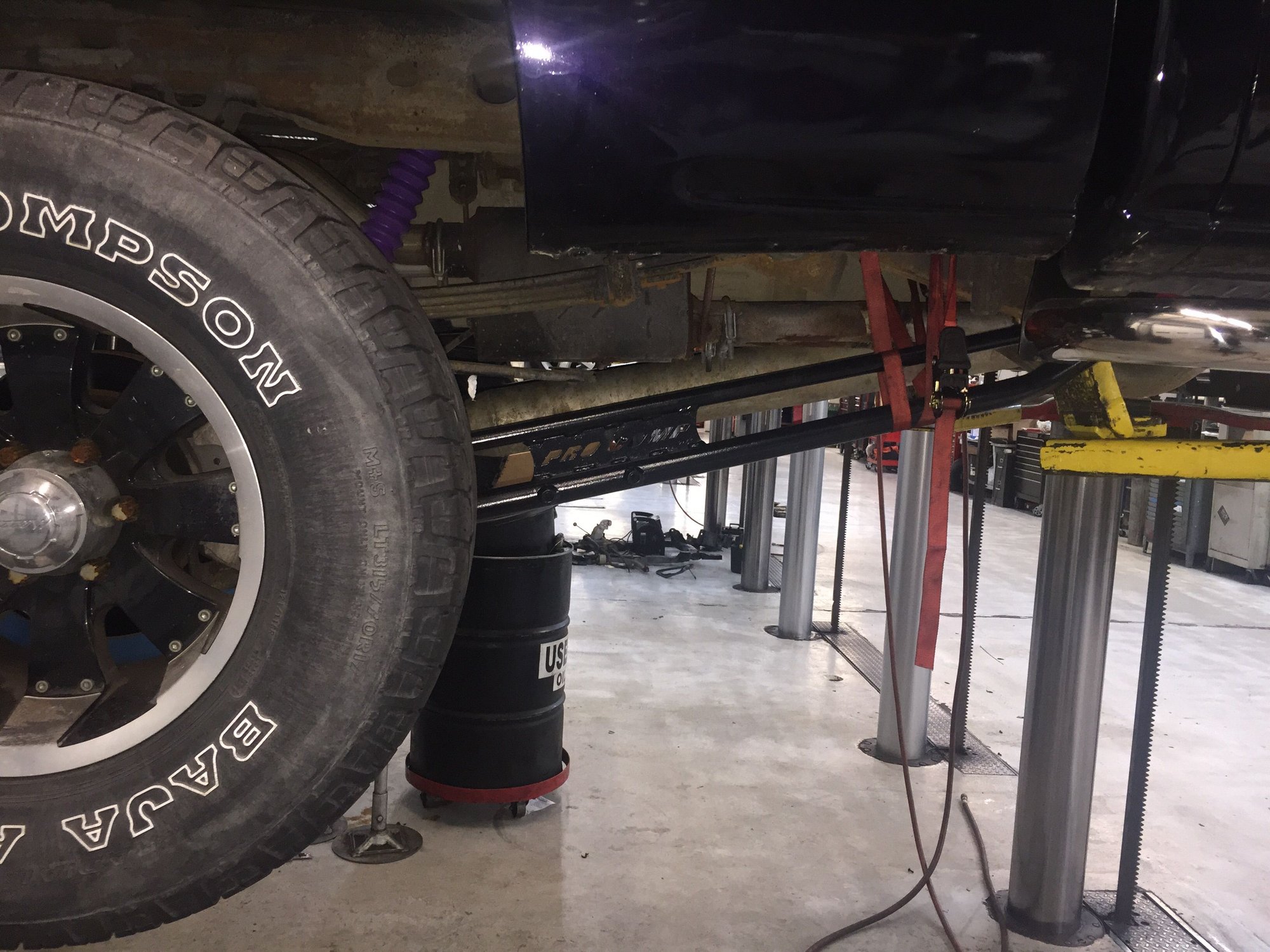

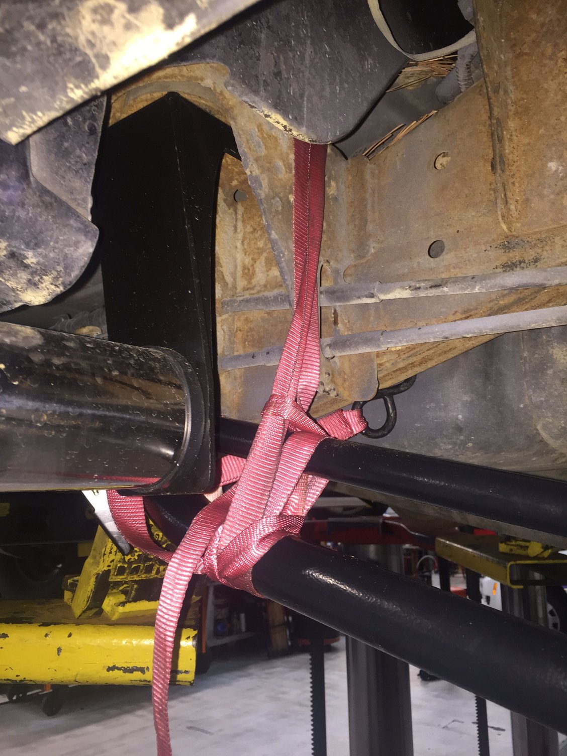

Well got my add aleafs,new blocks and bars mounted at the axle this evening, ran iut of time (and the patience) to drill the holes in the frame, so i had to use a little bit of redneck ingenuity to get the truck out of the shop, and ratchet strapped the bars to the frane temporarily....
New blocks, u bolts and add a leafs in place... And i lost a damn shock nut
Bars in, and about same angle as driveshaft...granted the truck was on a lift, but...
This started out as a temporary fix to hold the bars while i got everything together at the axle, and tightened it all up....
