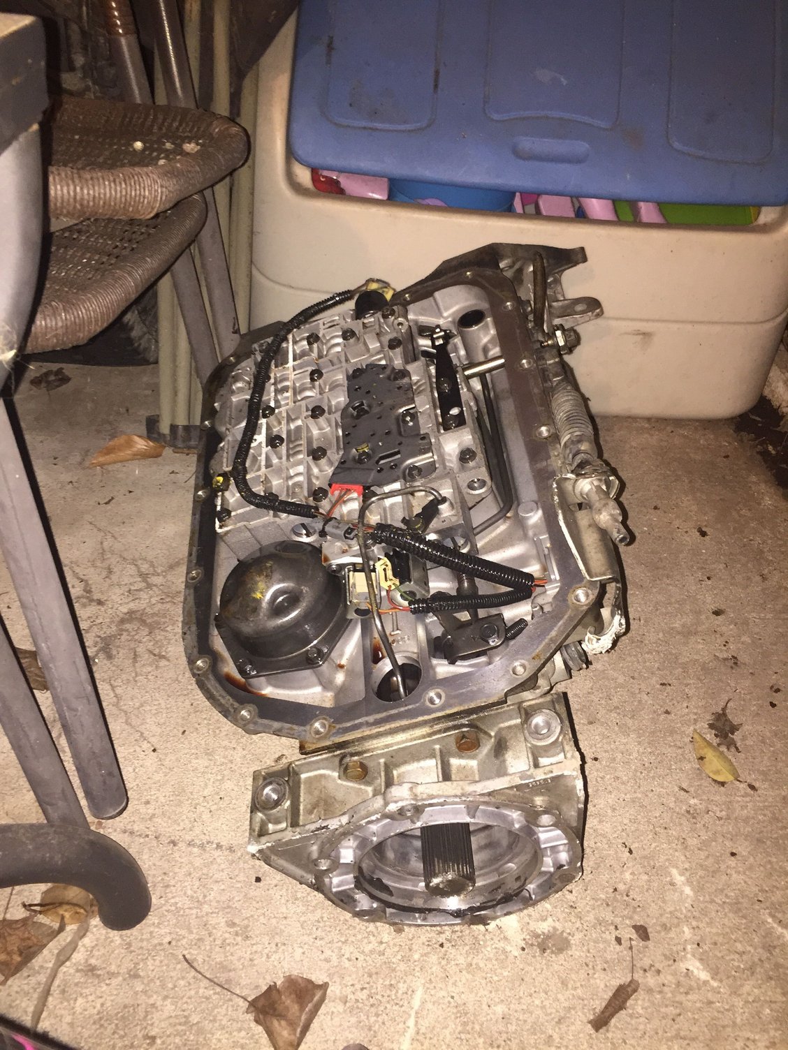

So...... Yeah i have no clue what its going to go in, but i cant pass up what im getting em for this weekend from pick n pull... They have an 02 3500 express or savana with a 2wd 4l80 im going to go get tomorrow, pulled most of way today have converter and bellhousing bolts left... Thought engine and trans were coming out when i dropped the crossmember.... Scoped it out monday, and found this still attached to a 246 tcase,
..this has a busted case but is 4wd and internals seem to be good everything turns anyway.....
Going to grab the input shaft from the np246 along with the 2wd 4l80 tomorrow, unless someones already snatched em!!!

Good find! You going to tear em both down and pick between the best internal parts? Are they both post 1997? trans?

Yeah thinking the 4wd is an 04 or later, has a silver epc....the other is coming out of an 02

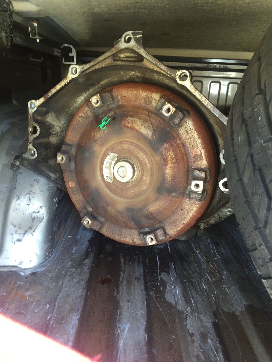

Got the 2wd 80 today......
Lets hope i dont drop this one out of the truck twice on the way home..... Also got the input shaft out of the np246 the 4wd trans was attached to..... Price on adaptor.... "Dont worry about it!!!" The transmissions with core charge were 104.68 each the core was 29.99....
