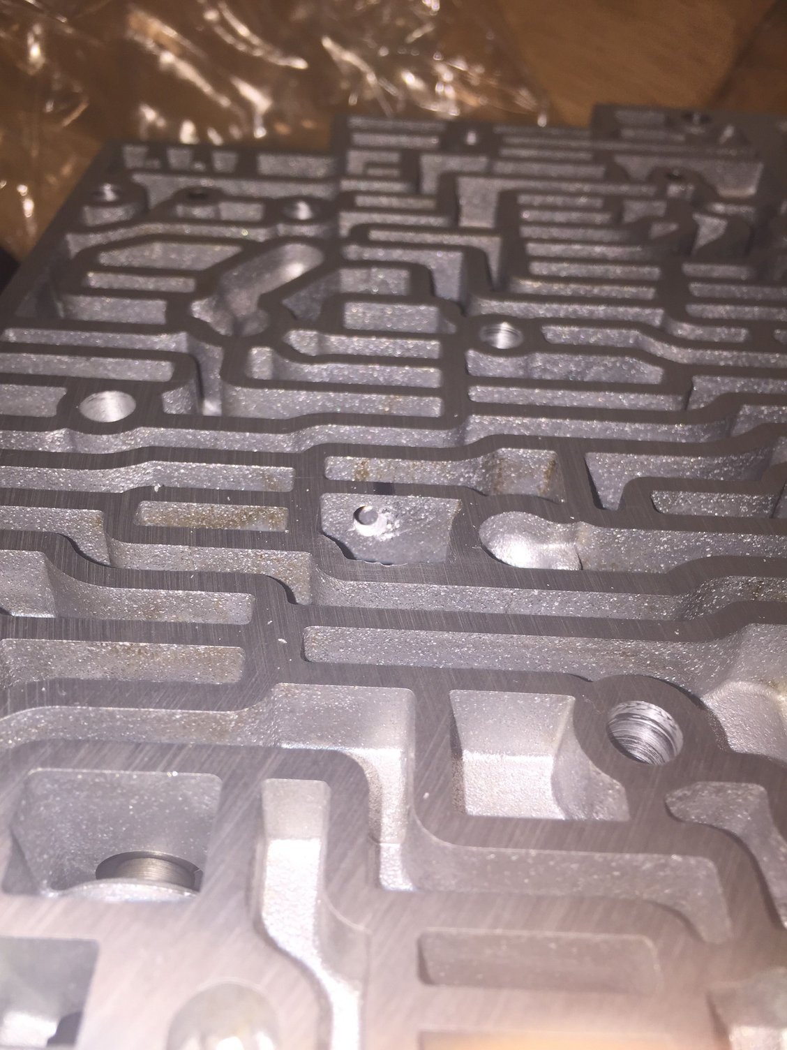

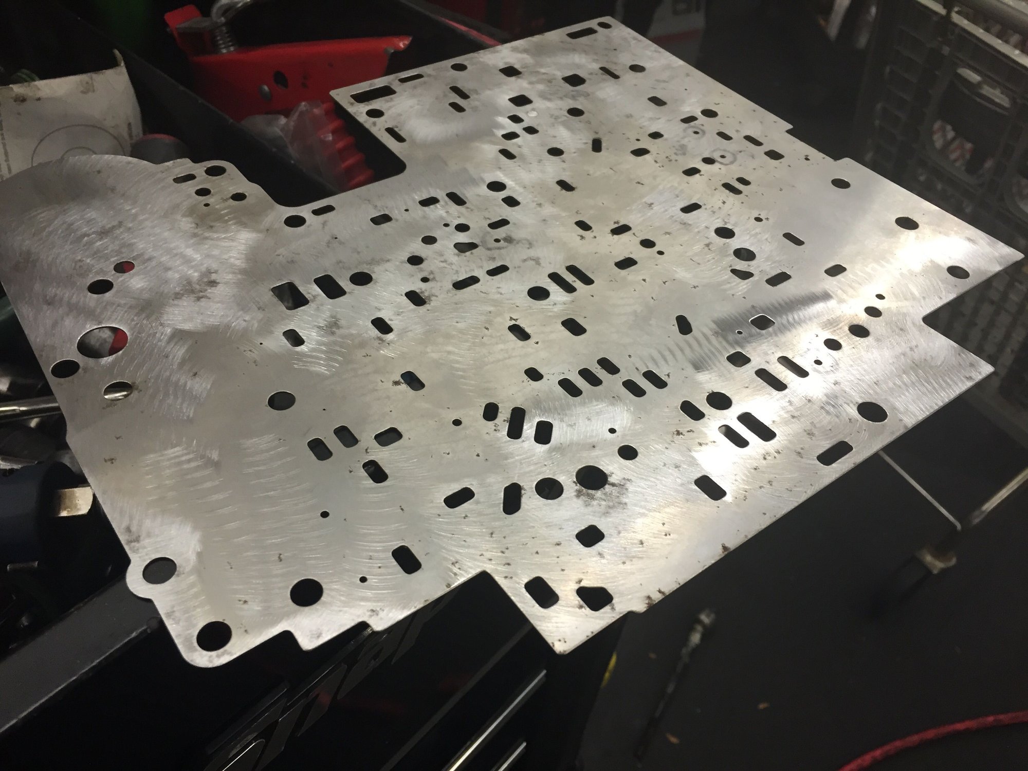

Ok got the valve body drilled for the the 2-3 shift valve and the separator plate modified.... I went ahead and used the factory plate that came with my valve body... Just need to get the surface rust off of it before i install it, decided to go that route, so i either have the transgo plate as a backup or can return it and get some money back from it......
1/8" hole drilled through valve body for the hd2-3 shift valve as per sonnax instructions.....
Separator plate marked and drilled......

Still need to dril and block the pwm feed hole

Well after a 12:30am walmart run for a $15 set of drill bits..... My pwm feed hole is plugged, gonna see if i cant use a real hammer and a vise at work to peen it a bit flatter tomorrow...

Pwm plug peened... Amazing what two taps with an 8oz ball peen will do to a 1/16" piece of aluminum...
Separator plate post rust removal....

Wow, that cleaned up nicely!!
What did you use to plug the pwm hole?

Sonnax kit has plugs for the pwm hole included... Took my die grinder with a 3m disc on it at about 1/4 throttle, just barely grazed it til the rust came off.... Ill probably hit it again with trans fluid soaked steel wool before it goes in....
