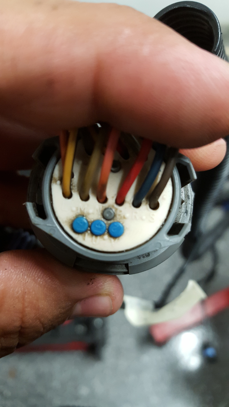

Old Mar 27, 2016 | 09:27 PM
  #166
Jake75's Avatar
Joined: Mar 2013
Posts: 808
From: Houston
Any help here? This is the connector on a red and blue connector harness dbc. Nothing really seems to match up.
