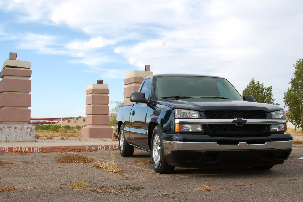

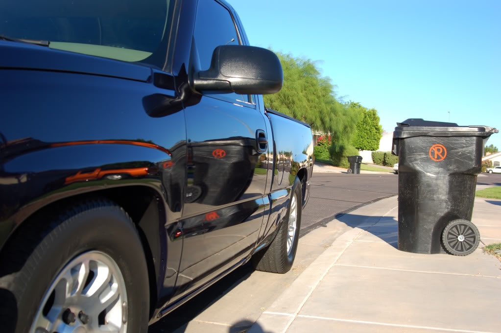

You might need to roll the lips out back with that tire, here is my truck 3/5 with 275/60/17 on all four corners. I never had more than an 1 1/2 of travel. If i did the tires would make some contact.
I think it will depend on the tire too, with mine the tread would clear the fender but if i went much lower the bulge in the sidewall would hit

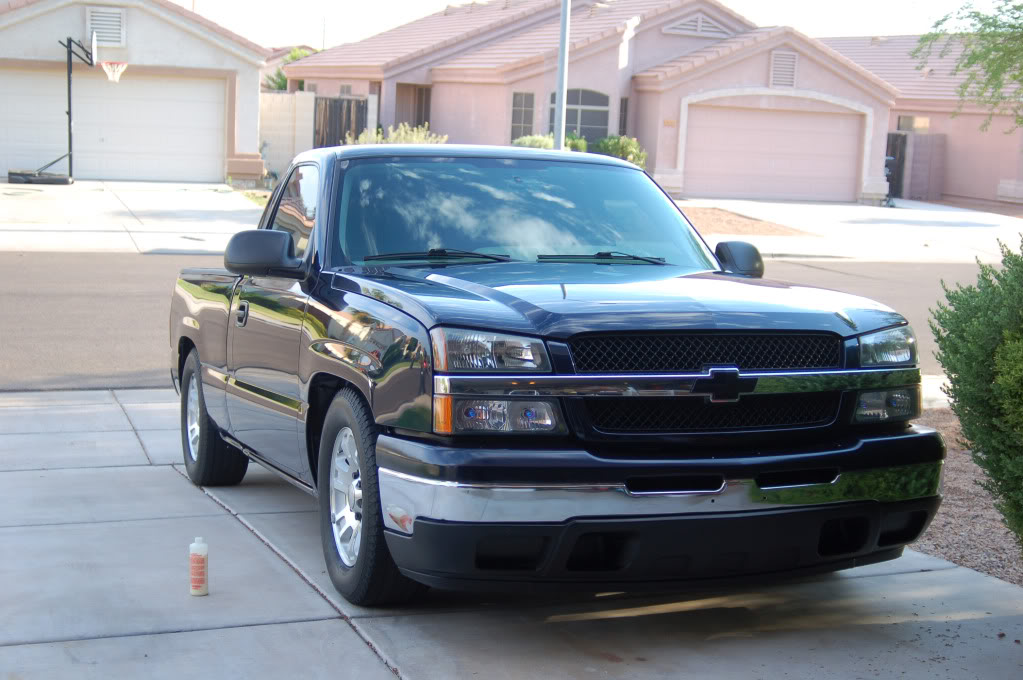

275/60/17

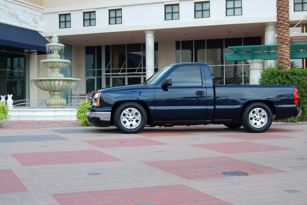

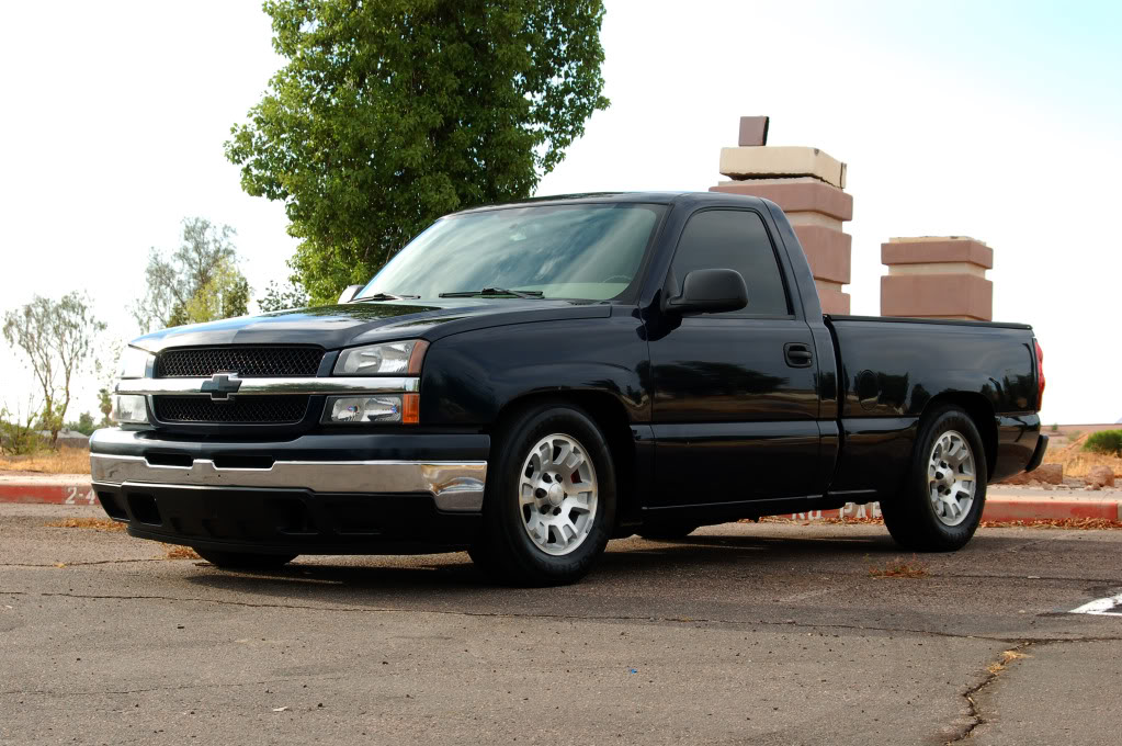

245/70/17

dang i think i'm sold on the tire sizes i had in mind. thanks.
