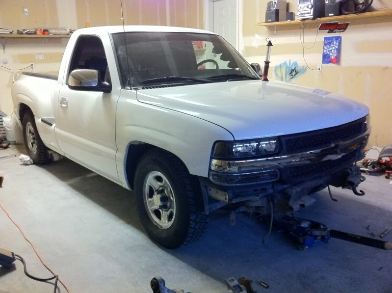

So here is a thread for my 2001 Silverado SCSB stepside with a 4.8 and 4L60E and 4 wheel drive. Decided to pick up some parts and do the AWD swap on it. So parts include:
NVG-149 Transfer case with less than 10K on it
Front differential out of AWD equipped vehicle
AWD front drive shaft
So I had the parts looked over by a trans shop down the road and the guy said everything looks good so I will be doing the AWD swap now that the garage space is available. Ill try to take a few pictures of the swap.
