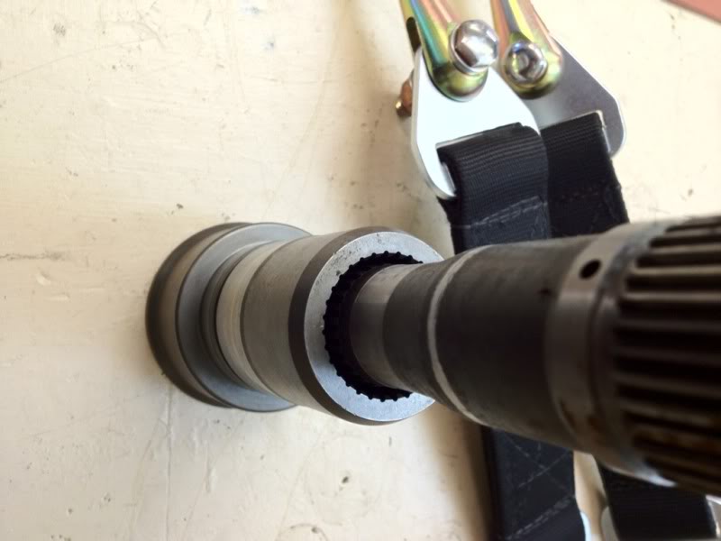

If it came from a 2500hd then chances are it was bolted to a 4l80e which has a larger transmission output shaft. If this is the case there is a good chance your smaller 4L60E output shaft is just free spinning inside the larger 80E input housing on the T-Case. This would cause your problem you are having.
This transfer case input adapter pictured is different then yours ( this is a AWD one) but you can see in the picture this is comparing a 60E output shaft to a 80E transfer case input. Big difference in size, as you can see its not even close to engaging the splines.

alright thanks for the insight on this subject. i just thought that the shafts wouldn't fit together, but this explains why it was so easy to line up. it just fell right in place both times i put it in. Thanks for all the help guys.
