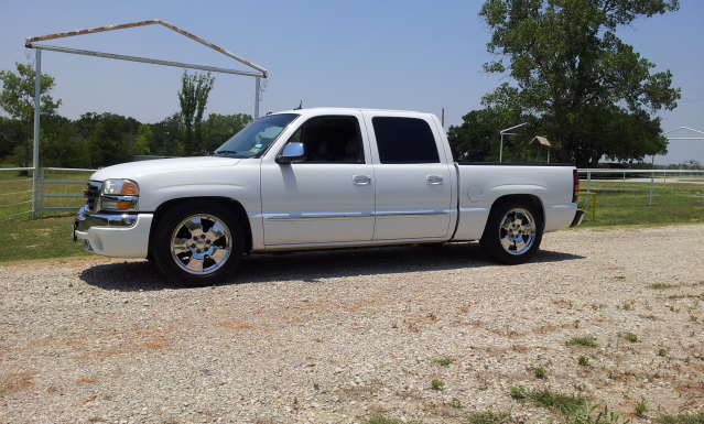

heres my 99 ecsb with 2/4 on 245/70-17's I had 265/70/17's on there before but i would rub fender wells in the front.

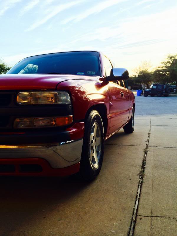

It's a rcsb but it's a 2/4 295/45/20
