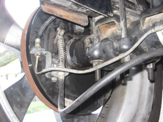

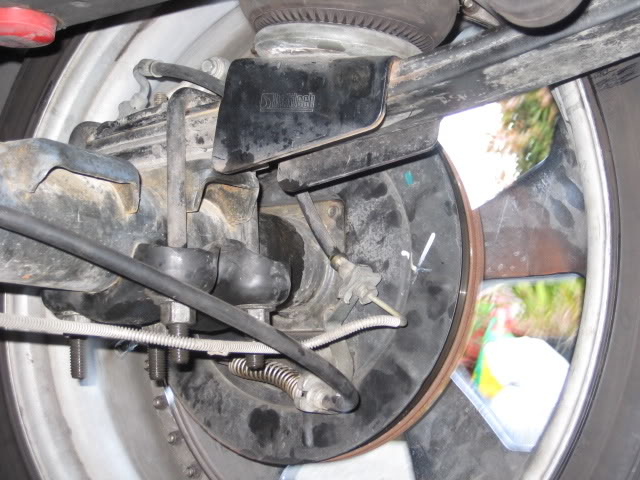

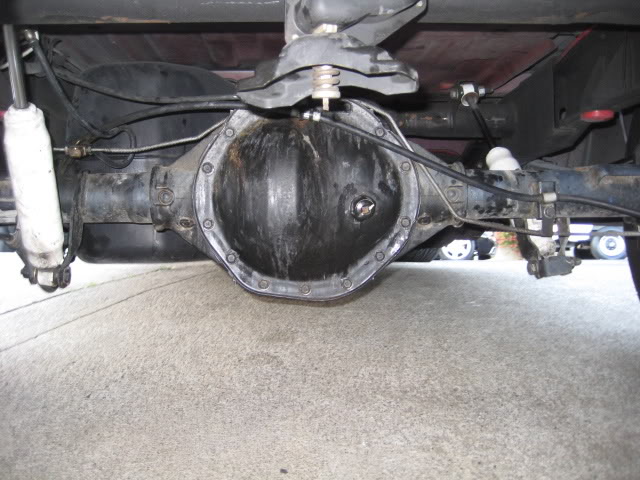

I had the 14 bolt swapped in today. The 2005 VHO 14 bolt was a direct bolt in.
For those interested in doing the swap...
The factory disk brakes will bolt up.
A 1320 to 1350 conversion u-joint is needed with the 1350 straps. (I will eventually put a 1350 yoke on the driveshaft.)
The driveshaft does not need to be cut.
The 14 bolt is much heavier and the axles are way bigger! I would say close to 50% larger.

Just wondering, haven't searched at all, do you know, say i got that same axle (my truck being rear disc) would i just hook the brake lines to the new axle without modification?
Also looks good, it looks like a tank compared to the 10 bolt.

You need to remove the disk brakes and bracketry and bolt it onto the 14 bolt. The disk brake do sit at a bit of an angle, but bolt up ok.
