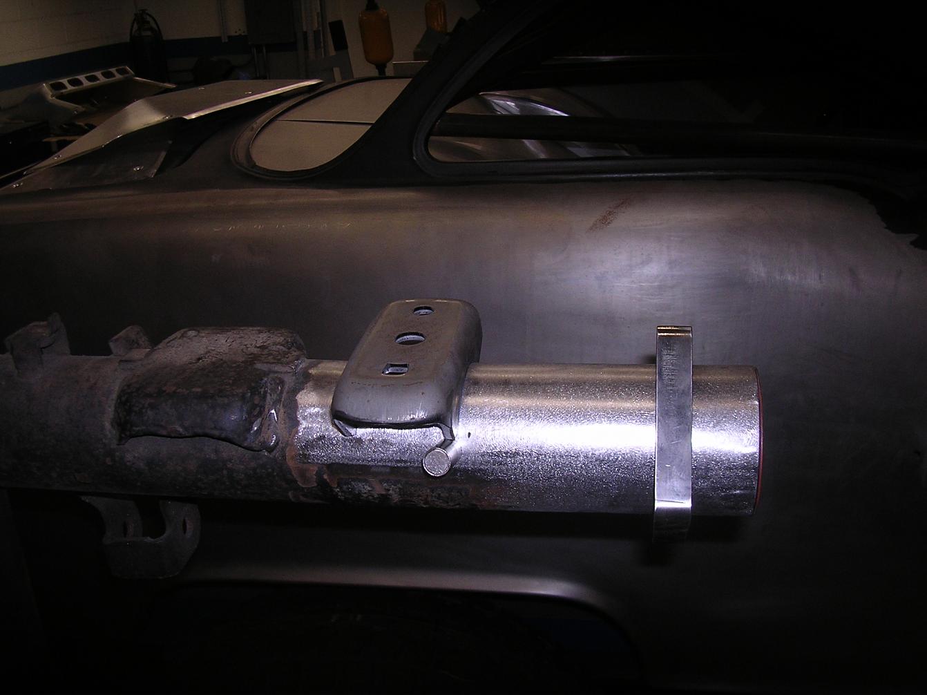

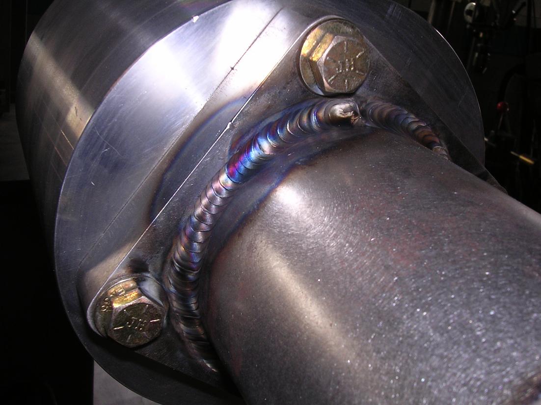

Yes sir! I had a batch of flanges made and there all ready.
No one makes a disc for the line up bar to work on a 14 bolt 9.5 SF so I had to buy some for a Dana 60 and turn them down. Unfortunitly I don't have my own shop so I have to wait and go down between Jobs and use a friends shop.
I was also waitning for some one to drop off the housing... Finally got it like 2 days a go so now I can get started.
Basically you cut the old flanges off and weld new ones on in the correct spot. I will take some pictures and document it. unfortunitlly I have to work around everyone elses schedule on these types of projects...

Well Lance this project finally got finished so I will Give you guys a sneak preview... We cut the old flanges off and welded the new ones on...
Just wait untill you see the final product!!!

Looks good, but why did you decide to go for the 14?? A built rear would have done you jut fine.. Just curious, def a nice neat install..
Im on my 4th 10b rebuild!:nunchuk1:
