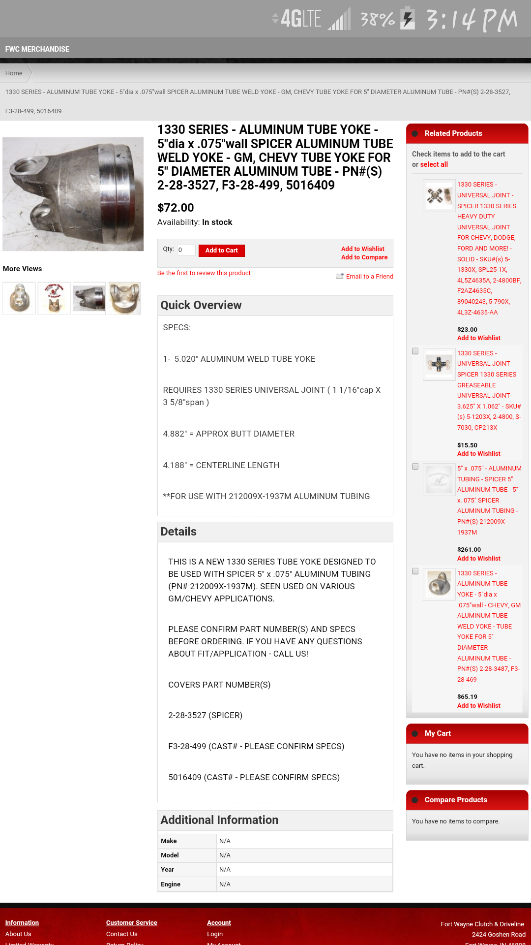

I have the BIG aluminum one piece. After digging all thru the sticky and your previous post. I sat down one more time dug thru all my part#'s and specs. I ended up with a moog 448. 1330 to 1350 combo joint. Thanks again for everyone's help!

I'm not sure that's going to work. Half-ton trucks are 3R, not 1330. The adapter joint you'll probably need is 3R to 1350. Google "DS U-1153".

This is what rear yoke is on my driveshaft. Same as a 1330 same as a 3r?
Old Jun 6, 2016 | 03:42 PM
James B.'s Avatar
Joined: Mar 2003
Posts: 1,985
From: 33.91° -117.48°
Could take some measurements.
1330 cap is 1.0625" diameter and 3.622" wide end to end.
3R cap is 1.125" diameter and 2.556" end to end.
Old Jun 7, 2016 | 09:16 AM
fastoyzz's Avatar
Joined: Sep 2006
Posts: 44
From: P-Cola Fl
That's what i did... moog 448 fits perfectly!
