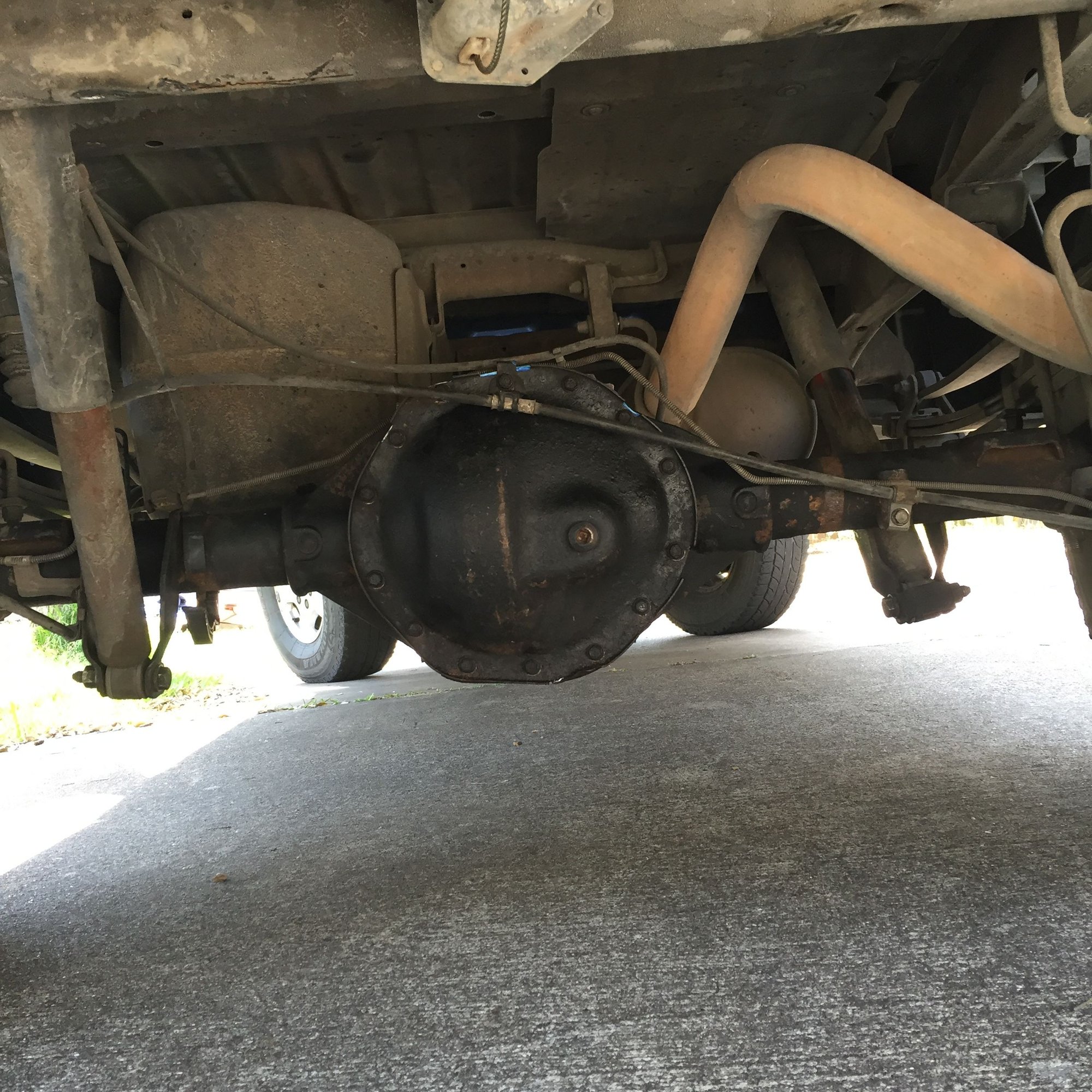

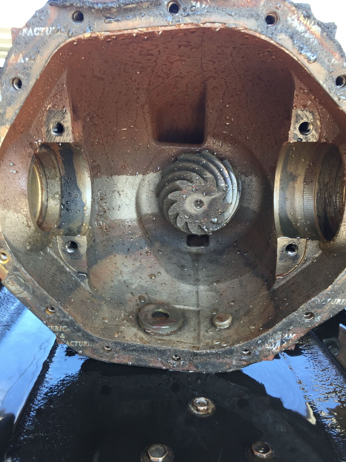

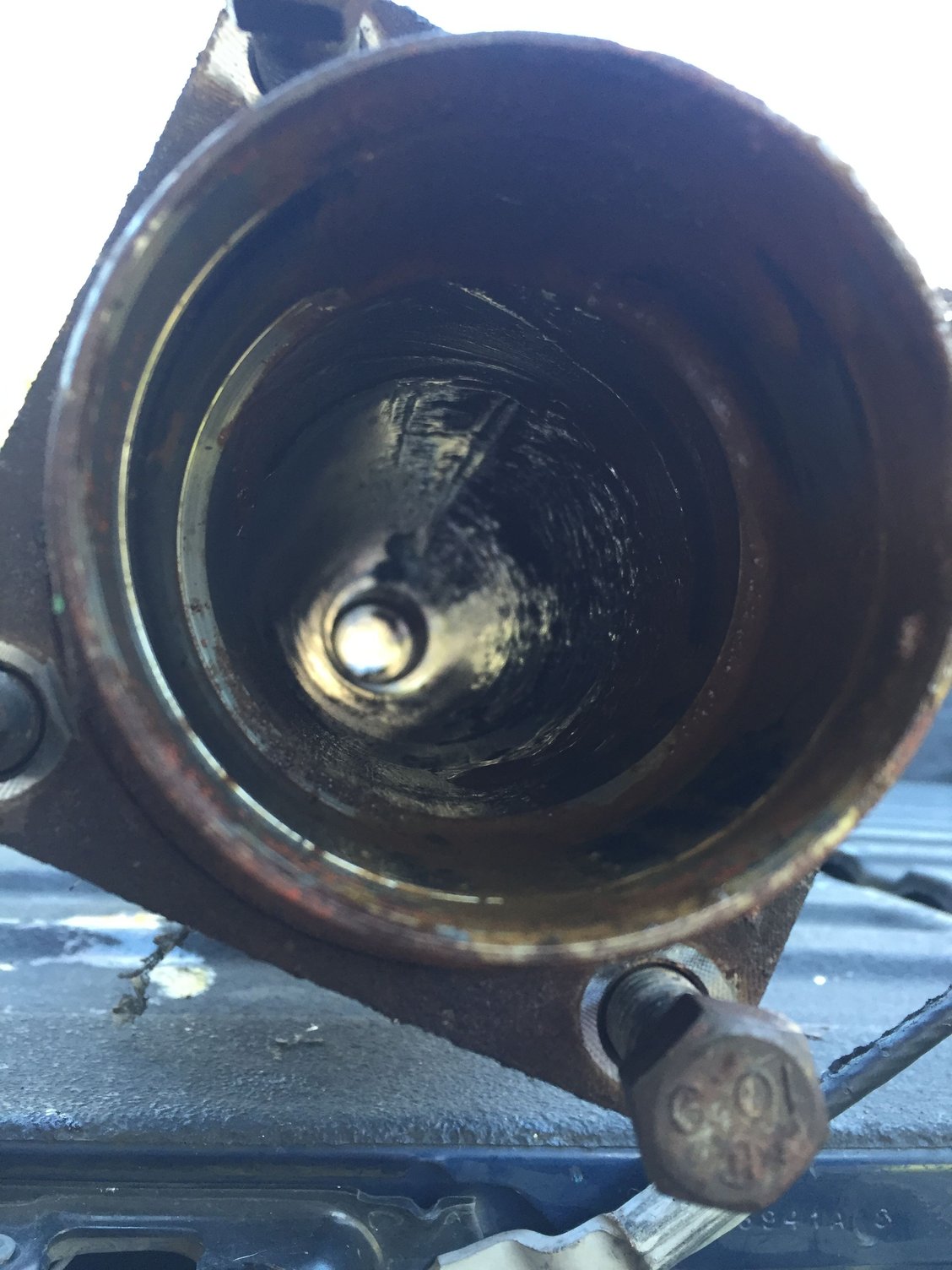

Old Feb 28, 2016 | 10:45 AM
zz454Chevelle67's Avatar
Joined: Apr 2013
Posts: 267
Likes: 67
From: Buda, Tx
Planned on swapping in 14 bolt Saturday morning but after pulling axles out I found axles tubes and diff had a lot of sludge caused by moister and oil mixing. Axle bearing are ruined but axles are ok. All carrier and pinion bearings seem ok as well. Ended up taking the housing to a car wash and cleaning inside.

Old Feb 29, 2016 | 11:27 PM
1FastBrick's Avatar
Custm2500's Rude Friend
Posts: 14,592
Likes: 900
From: JunkYard
Nice! That's how I clean mine before modifying them.
I hope you got the moisture out right away though... They start flash rusting right away and if you planned on re-using any of the bearings they will do the same.
Old Mar 4, 2016 | 06:36 PM
Joined: Apr 2013
Posts: 267
Likes: 67
From: Buda, Tx
I sprayed everything with brake cleaner and then WD-40.

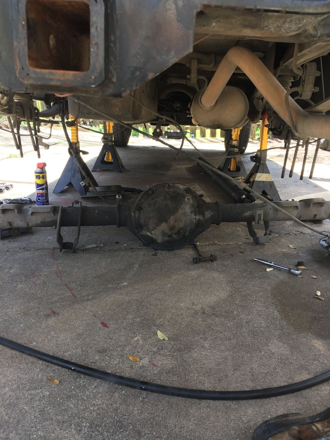

Old Mar 4, 2016 | 06:40 PM
Joined: Apr 2013
Posts: 267
Likes: 67
From: Buda, Tx
10 bolt finally out. Took off work and made time to do it.
Old Mar 4, 2016 | 08:10 PM
tgui's Avatar
Joined: May 2014
Posts: 1,252
Likes: 7
From: VA
^^ I've done the same!
Relaxing, a few beers and wrenching is downtime for me as well.
Awesome work brotato!
