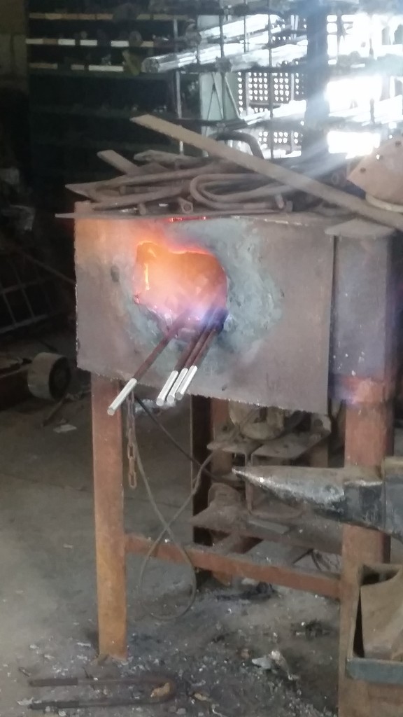

From: Arkansas
I found a shop that had been around since 1960. He made my U bolts in about 20 mins right in front of me I thought that was awesome.

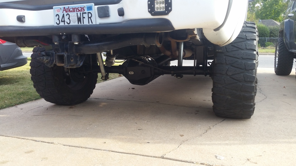

Everything is working perfect and the truck feels amazing. I can actually pass people when I need to now on back roads lol. I'm very excited about this being my first axle build/ gear job and it turned out perfect. I couldn't of done it without the awesome people and this awesome forum. Thank you
