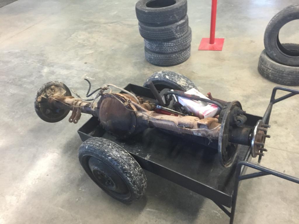

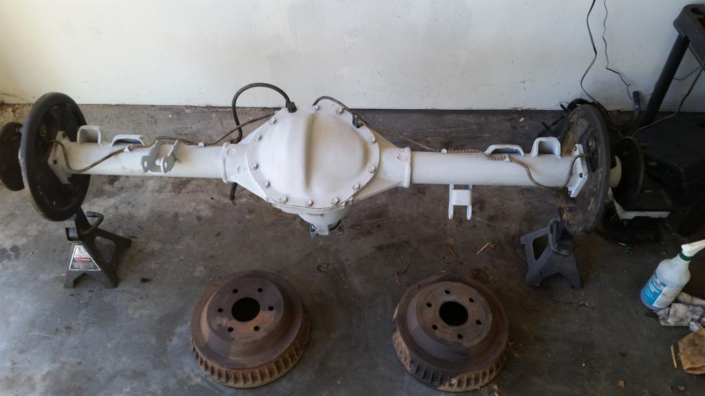

Hi guys I am new to the forum and was brought here because I was searching for 14 bolt 6 lug help and this forum was full of it. I am now building my 14 bolt and thought I would build a thread of my own. My first mistake: Out of excitement of finding a good deal I didn't pay attention and pulled a 2wd axle out of a truck. I cleaned it up really good and got a fresh coat of primer on it before i noticed.

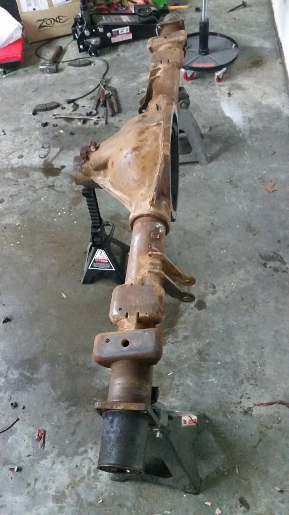

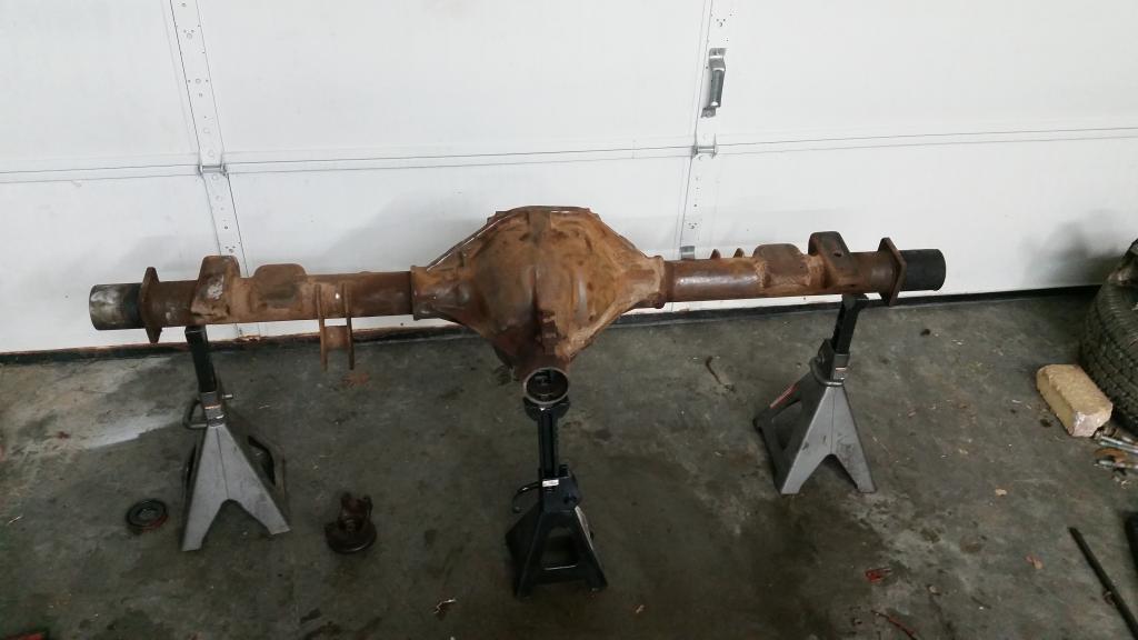

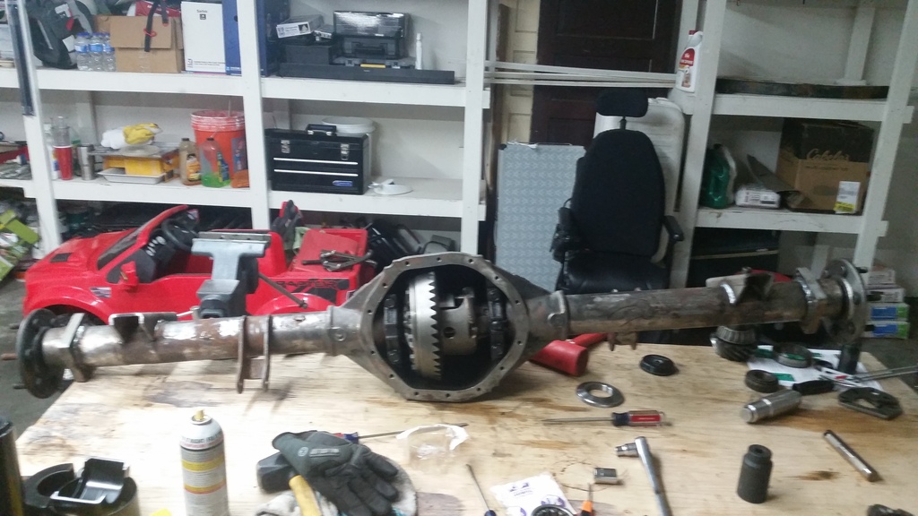

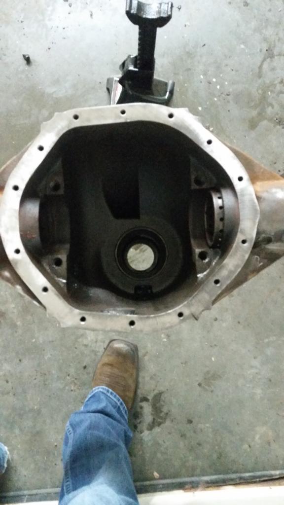

I finally got rid of that axle 2 weeks ago. Then I ran up to the salvage yard where i found 14 bolt 4X4. I pulled it last weekend.

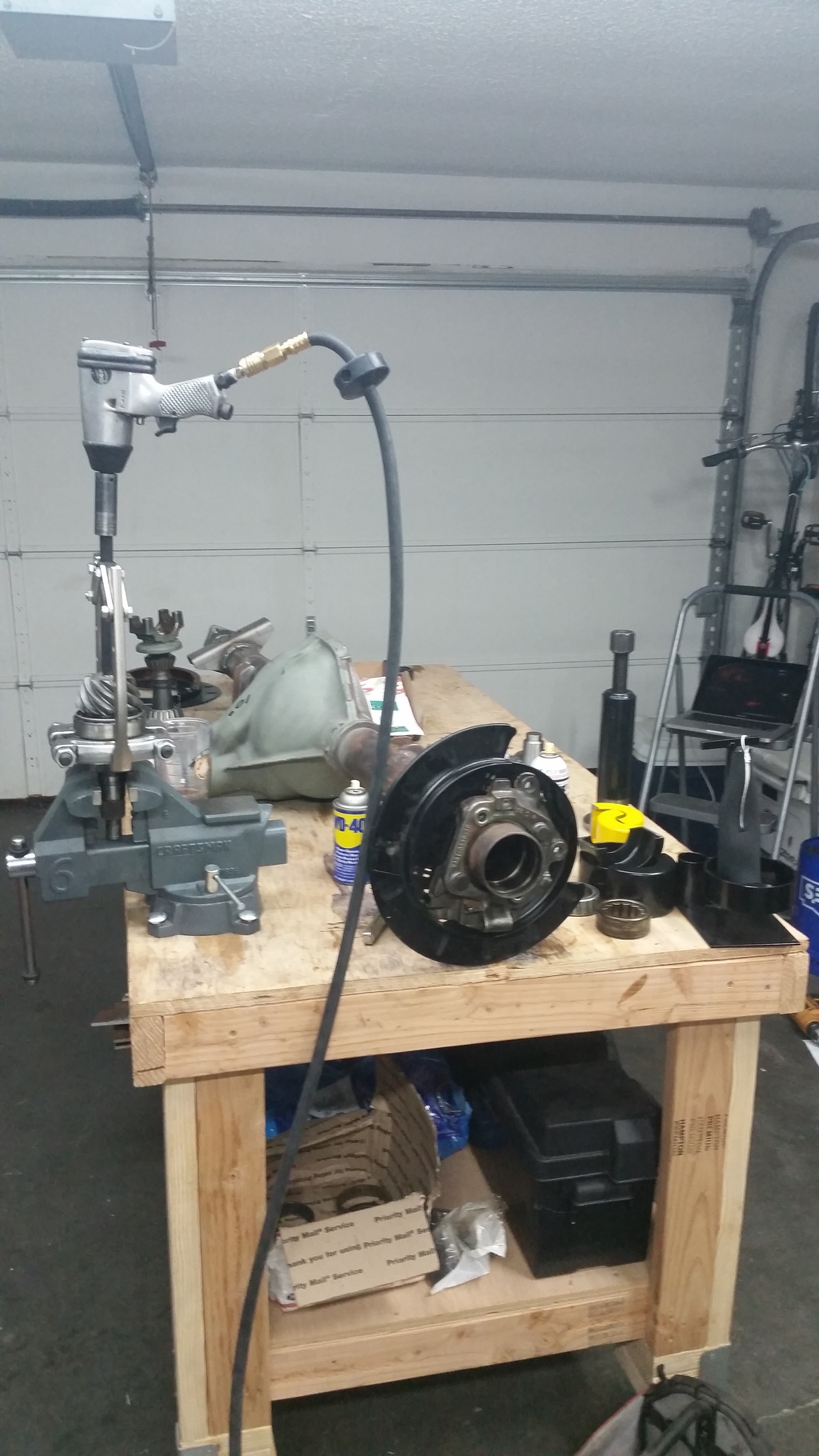

Im in the process of tearing it down and cleaning it. I have decided to re-gear this axle on my own. I will have to buy several new tools I'm sure but I know I can do it. I have already bought 2 30"+ pry bars to get the carrier out of the axle, and a bearing puller for the axle tubes.

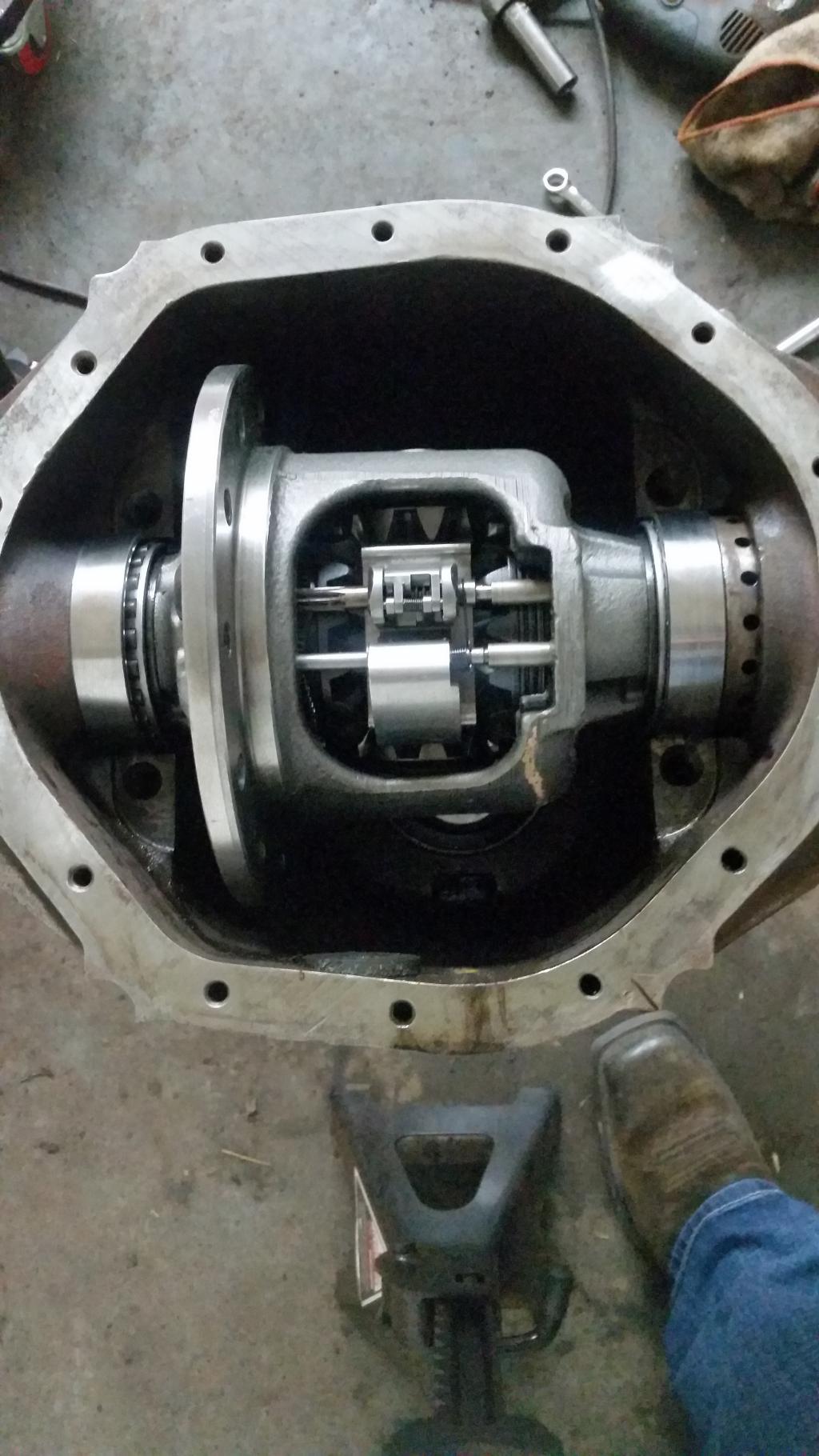

Im waiting on all my new tools and new gears to arrive in the mail. The recent snow storm put delays on everything. In my boredom I kept buying stuff and was talked into buying a Eaton G80 Posi

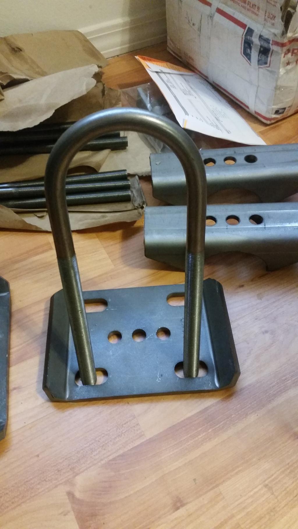

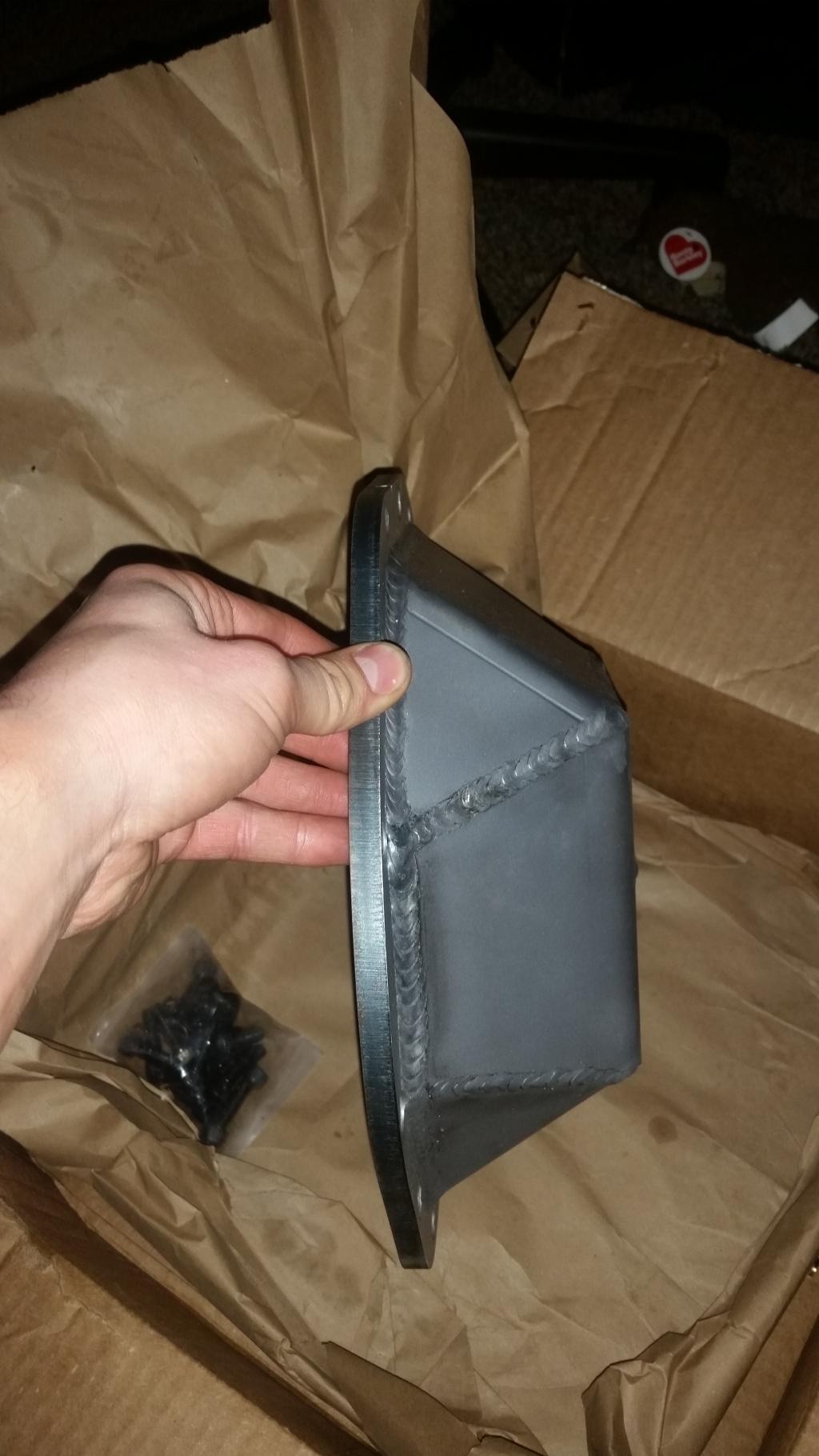

Im pretty excited about it. My ruffstuff simple swap kit came in along with my blue torch fab works dif cover.
Im extremely impressed with the diff cover its awesome.

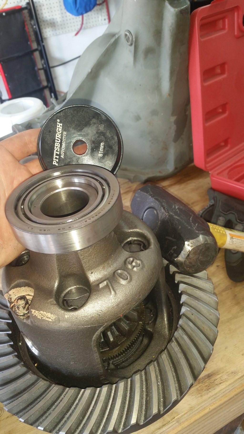

Ok the axle is finally rolling again. I bought a clamshell puller so I went again and replaced the carrier bearings, and it was a breeze!
A 5lb mini sledge and some wood knocked some news bearings on real easy.

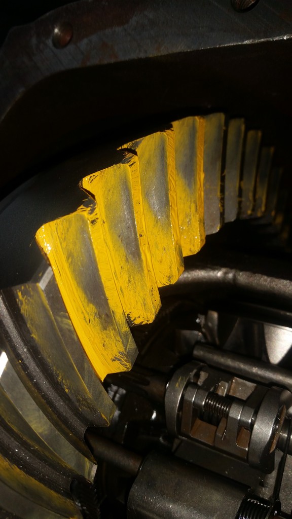

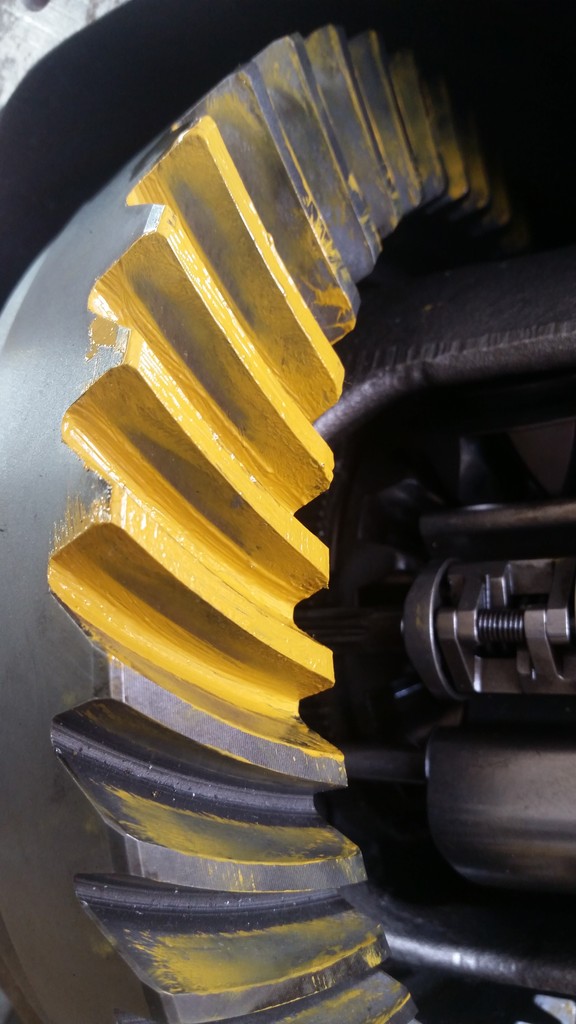

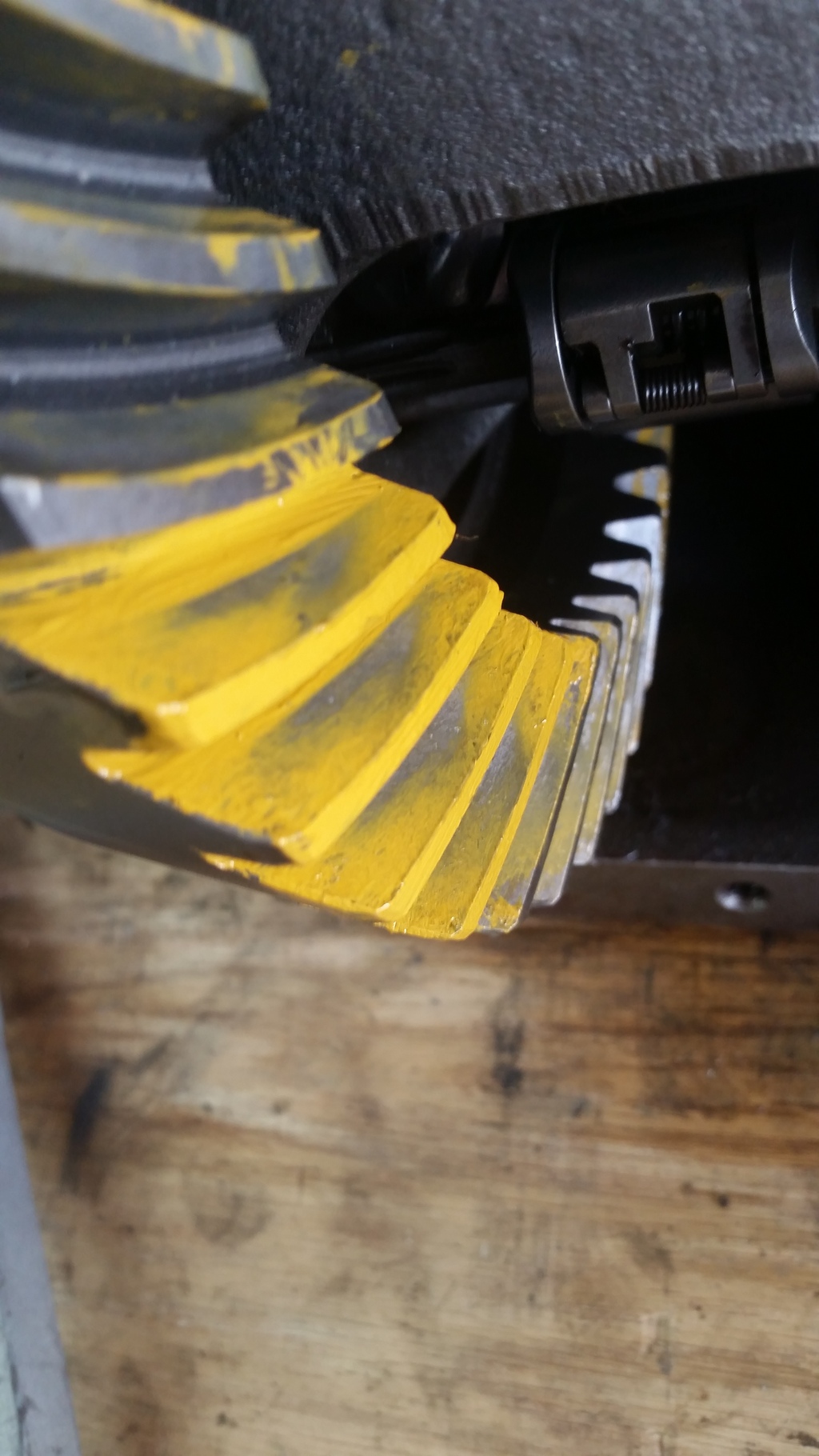

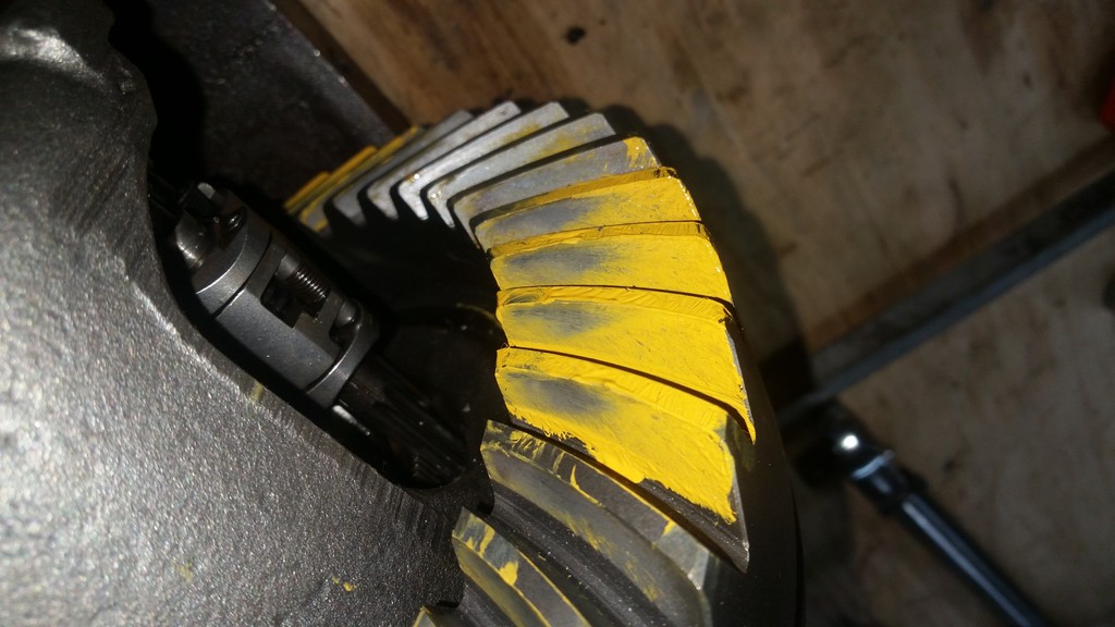

This well my gear pattern with factory shims. I add 2 shims to the pinion and set the preload and changed out the carrier shim with some 2 aftermarket thicker ones. Came out with a new perfect pattern I say.
These are brand new Yukon 4.56s, G2 master install kit. Yukon wheel bearings and seal. G80 was brand new pull off for 100 bucks. I don't have the money to put a Detroit locker in there so I picked this up instead.
