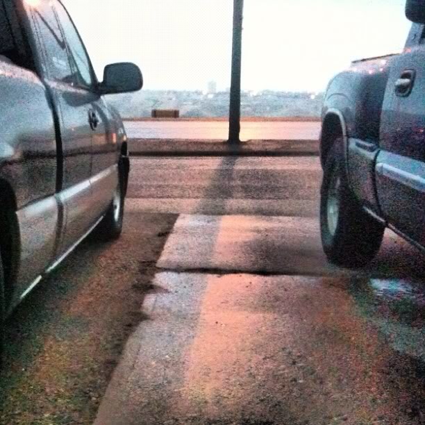

here is the best picture I have that kind of shows the front end. It is VERY close to aligning. I will see if I can get a better picture tonight.

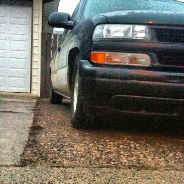

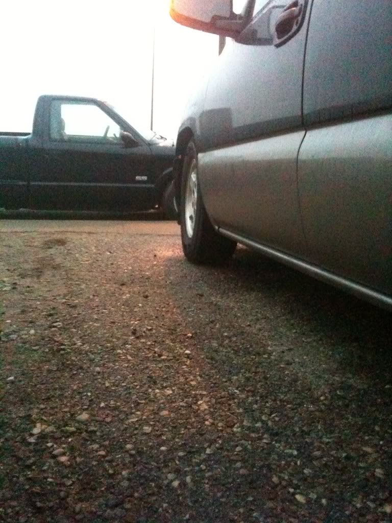

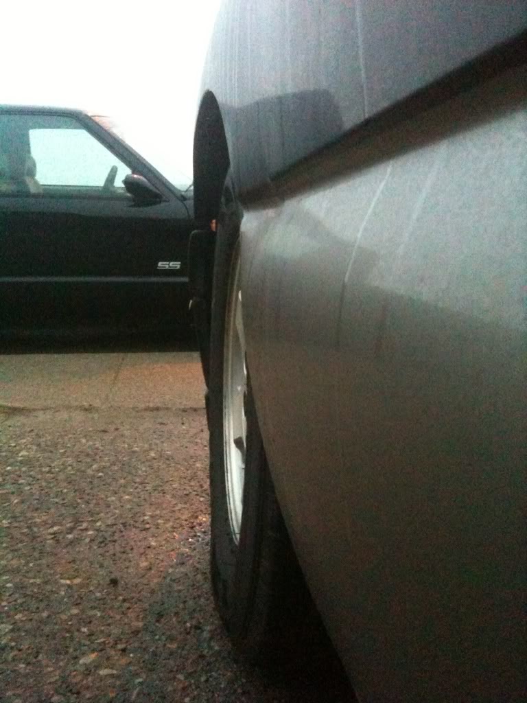

Thanks! Its still not low enough, but our roads dont agree with slammed trucks. Here are some more pictures from tonight. (please ignore the cancer on my box side haha)

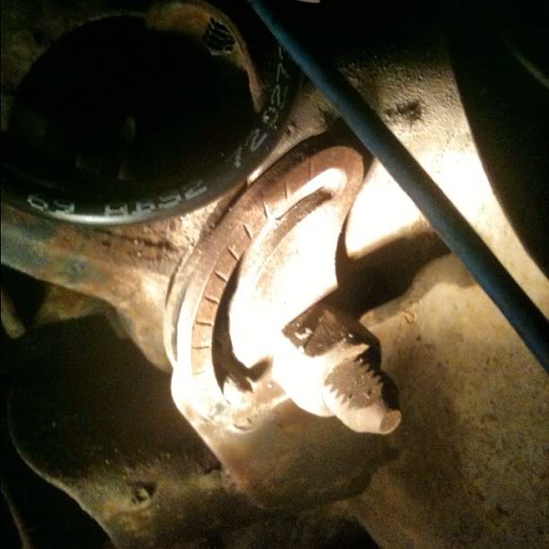

Ok, here is the alignment cam I was talking about. It's maxed out. I think I will make some laser cut pieces that have a little more adjustment. I would like to do a 1" coil up front still, and it will be a must then.
