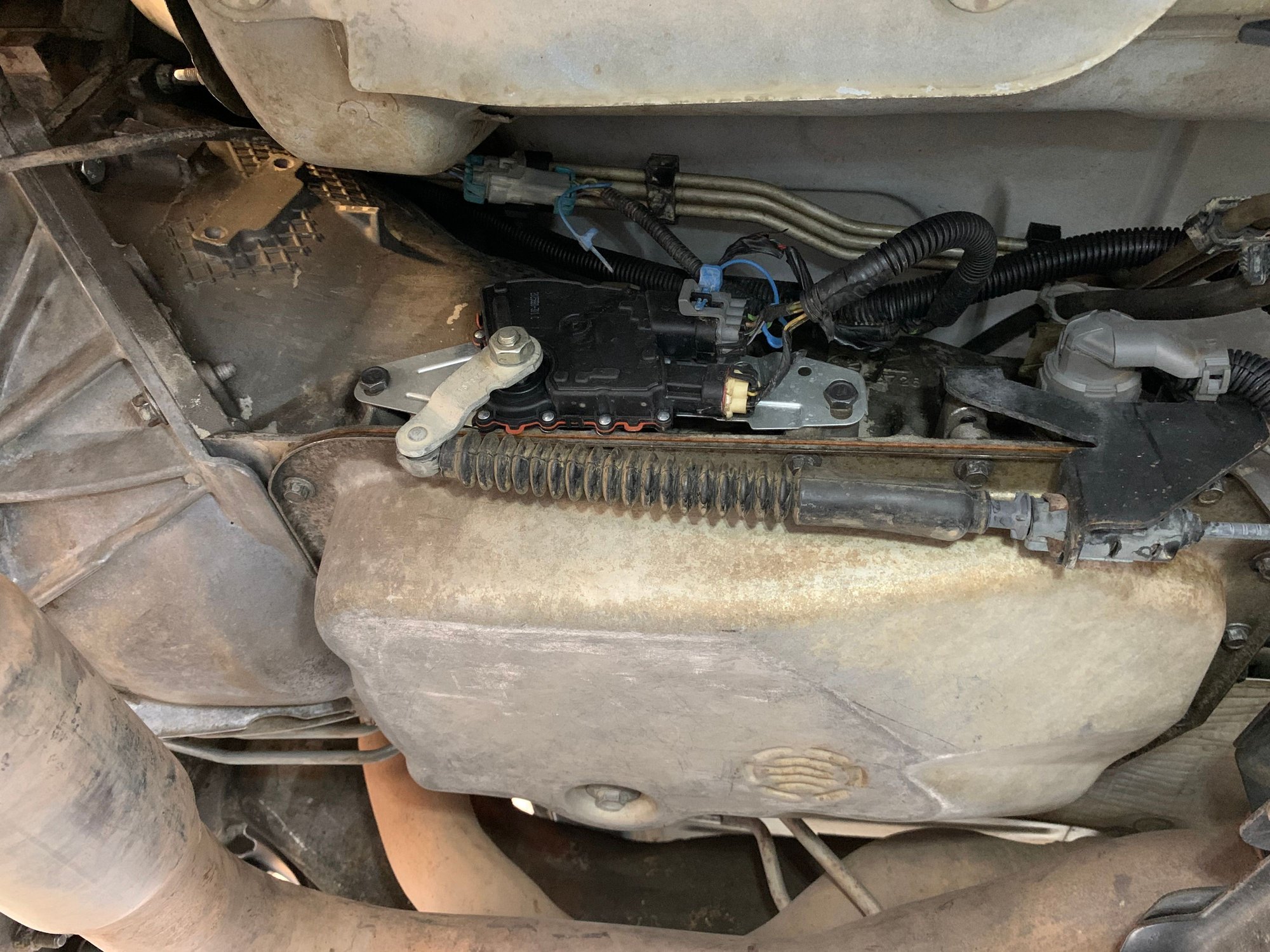

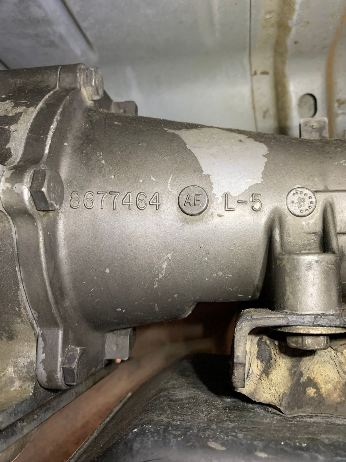

I'm not sure what year core i will try to find out today and not sure if he used the pump that came with this trans or the one from my original. it does have the same location fittings as my original one and i'm not sure if he used the new fittings that came in my kit for that. I did order on amazon fragola npt to an fittings to go to an style fittings soon. I took some pictures of my transmission

That has the rear fitting for cooler oil
so it is 97+ case
need to ensure the fitting is correct, and if that is correct, next need to verify the pump is correct.
I'd be pulling the front cooler line and just checking for flow to be sure the cooler is seeing oil

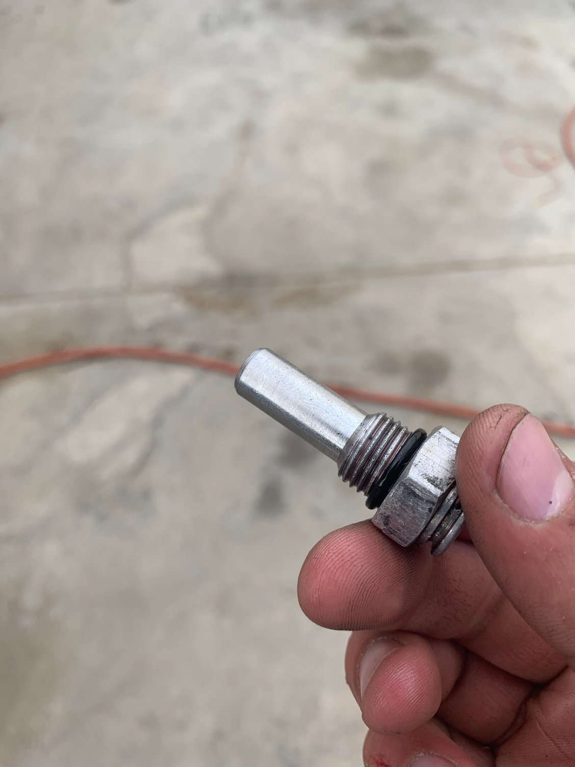

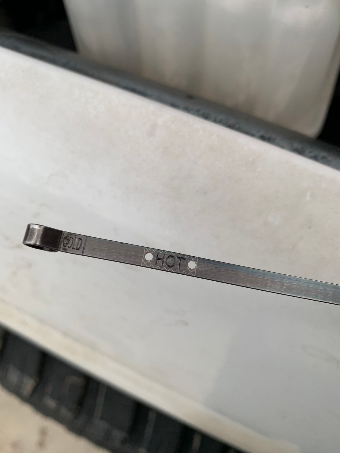

So i removed the line and started it up the pressure line puked about quart and 1/4 of transmission oil in bout 5seconds at a steady flow now too much that the hose would fly out of the bucket i had it in. i also pulled the fitting and it threads nicley into case and appears to be the right fitting. i drove it and took me about half hour to try to get it up to nearly 200F to check fluid and i got a consisent reading of the lowest dot in hot level. before i had it at the highest dot level. didnt go over 200
