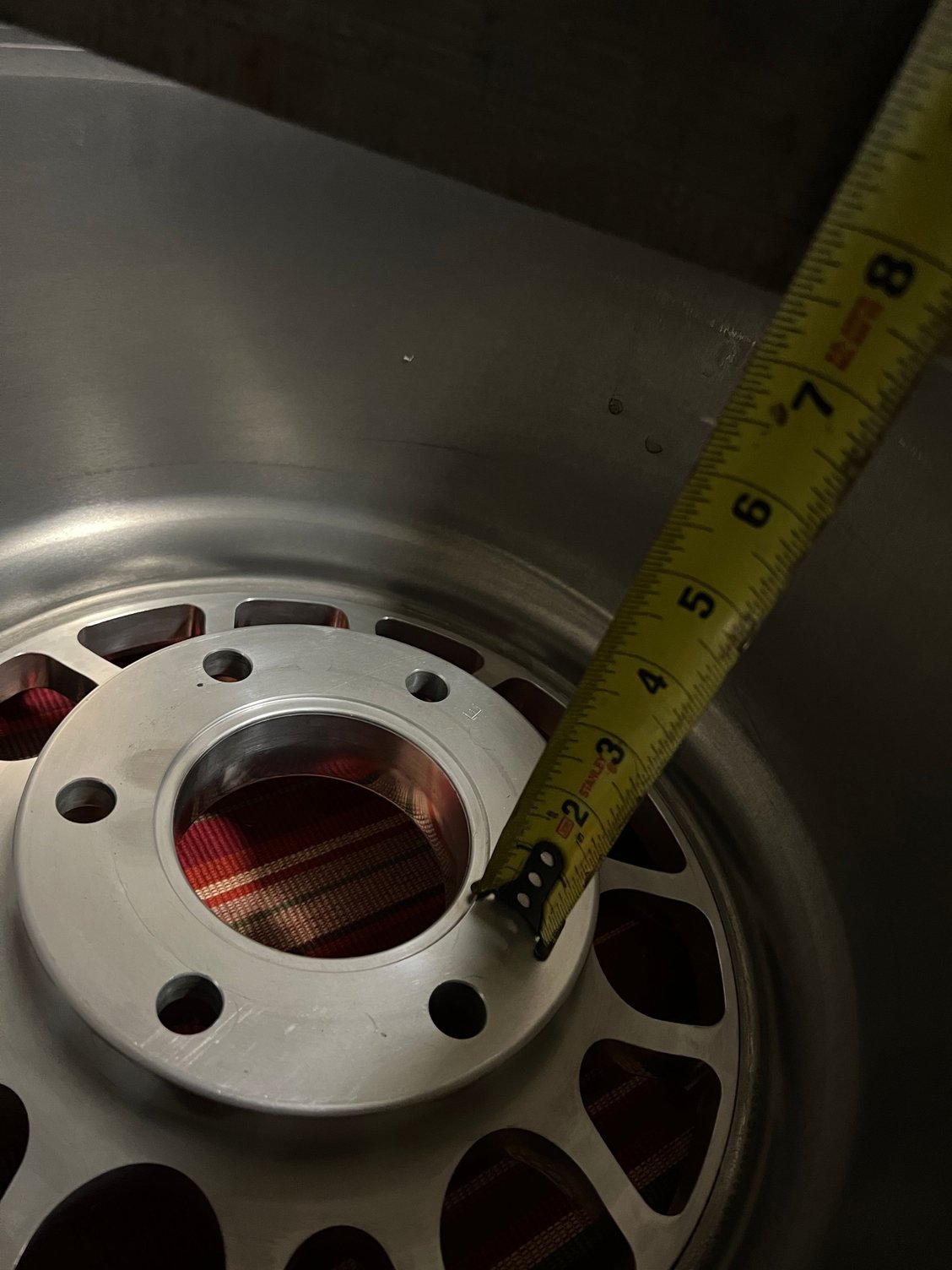

I just got my weld s77 HD 15x10 rims in. They have a 7.5 backspace. I mounted them an put a strait edge up flat on the beadlock surface ( without the beadlock installed) and the straight edge fit about 1/4 inch inside the fender lip. I hoped on running 315’s but realistically i think i need to go 295 and i will probably trim most of that fender lip away. My 20” tires sit about 2” inside the fender so i absolutely need them to tuck and i know they will bulge out when the pressure is lowered

Interesting. Did you put a tape on the wheel to confirm the 7.5" BS? My 18x9.5 have 6" BS and with 295/45/18 have the same 1/4" inset from the sidewall bulge. The 15x10 Racestars have 6.625 BS and the sidewall bulge of 295/65 Hoosiers barely protrude.

Verified 7.5 backspace
