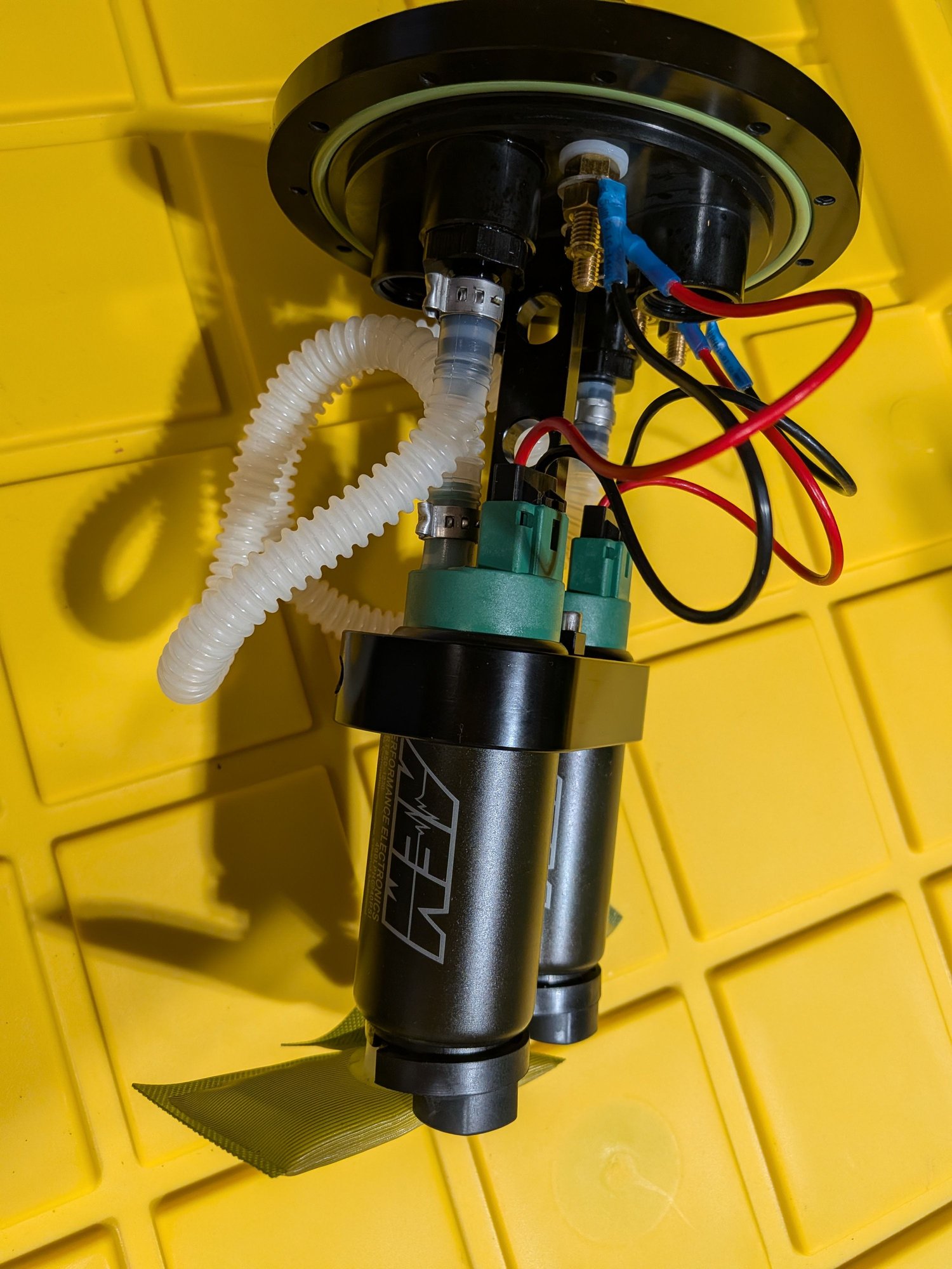

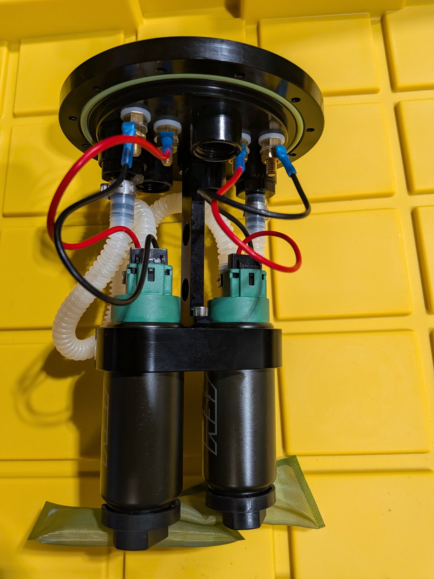

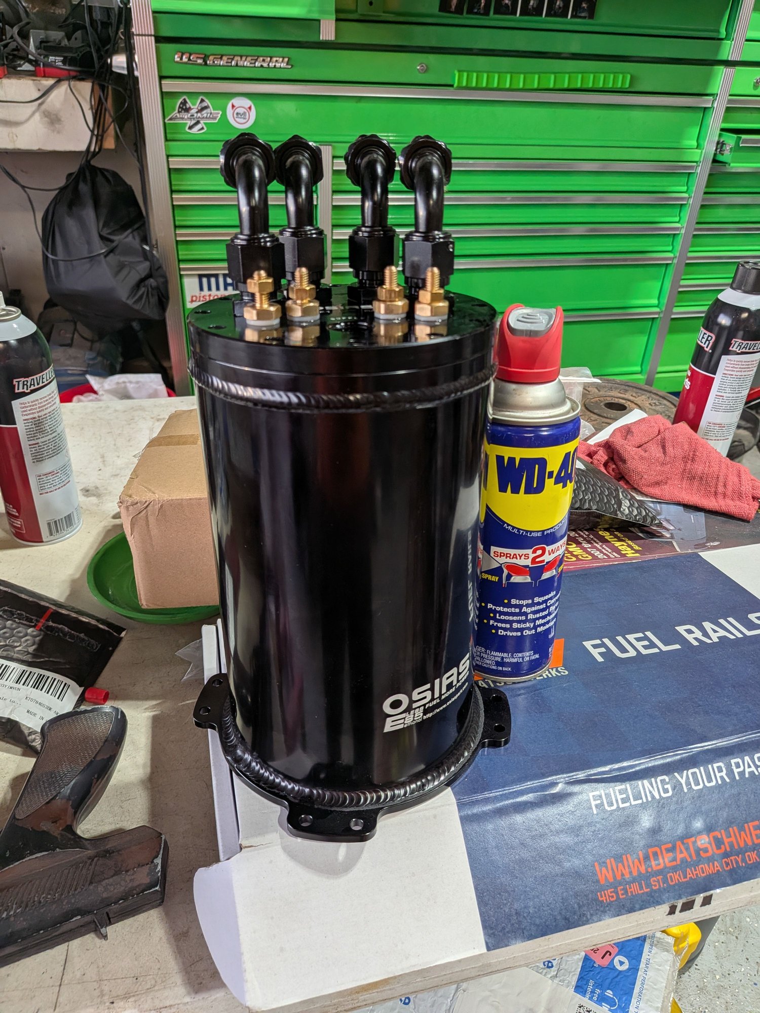

Old Mar 5, 2026 | 07:17 PM
HawkZ28's Avatar
5 Year Member
Joined: Feb 2018
Posts: 187
Likes: 26
Started putting the tank and pumps together. Working on it while I wait on pistons.....ordered 2/11 and they aren't scheduled to ship now until 5/31, so I'm building as much of the fuel system while I can in the meantime before mowing season starts again.
I used WD40 as lube and a few seconds with a heat gun to get the tubes on. Also found out the 90* fittings I ordered for the lid won't work due to interference with each other. I need to get at least a couple 8ORB to 8an adapters and some 8an 90s.

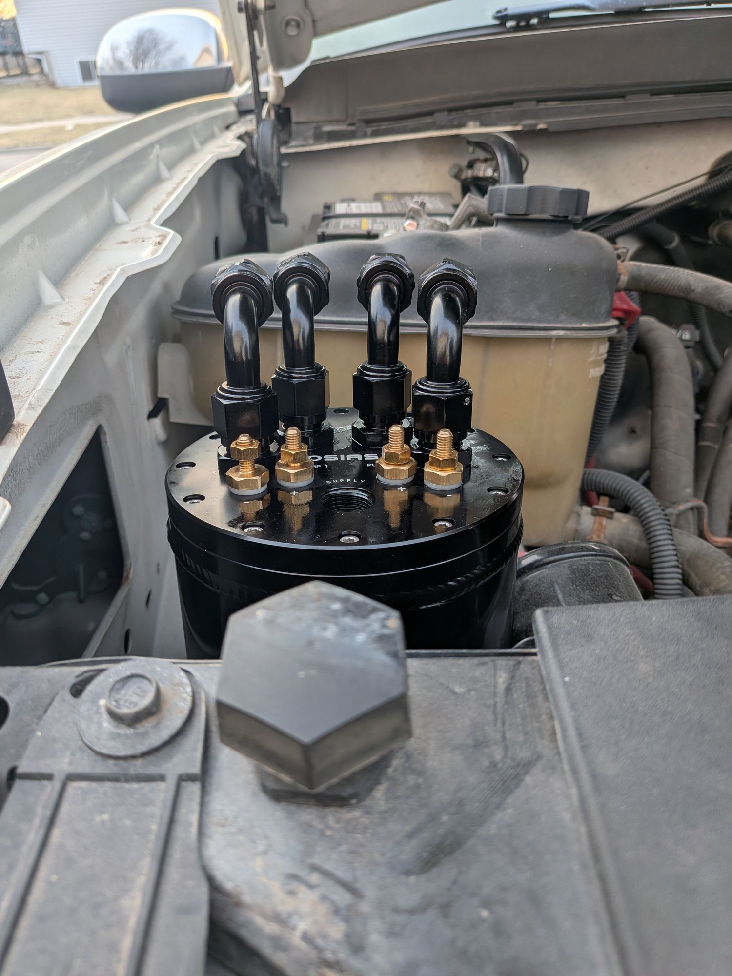

Old Mar 19, 2026 | 07:19 PM
HawkZ28's Avatar
5 Year Member
Joined: Feb 2018
Posts: 187
Likes: 26
Checked behind the tank. Vertical clearance but too close to the rear axle given it's thiccc....
After adding the fittings, it became "too buku" for everywhere but under the hood. It fits perfectly in the area the stock air box was. Hood closed with no issues.
