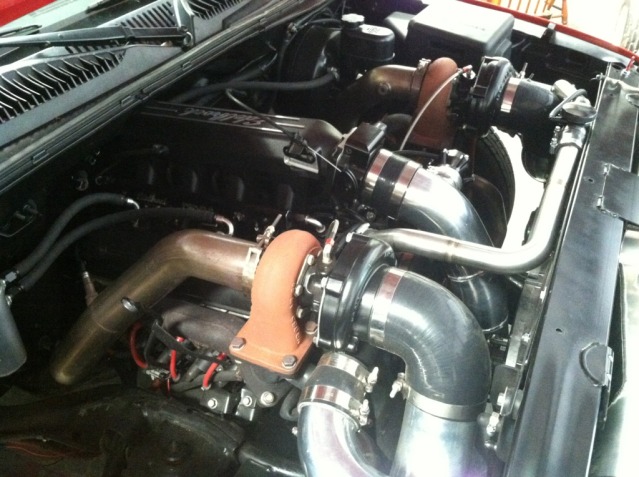

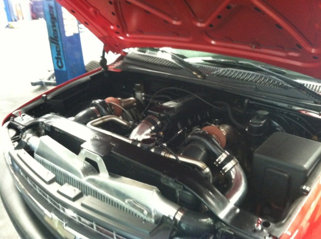

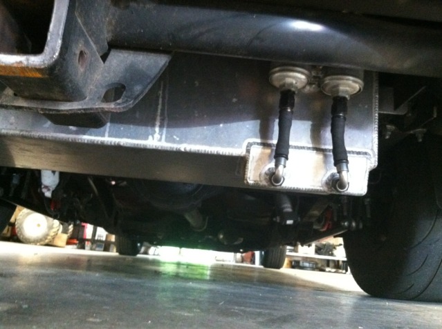

Here's some pics of mine, and TimDave217 check out my post with the pics of the injectors, FIC recommended these for 700+ rwhp.
https://www.performancetrucks.net/fo...system-501956/
