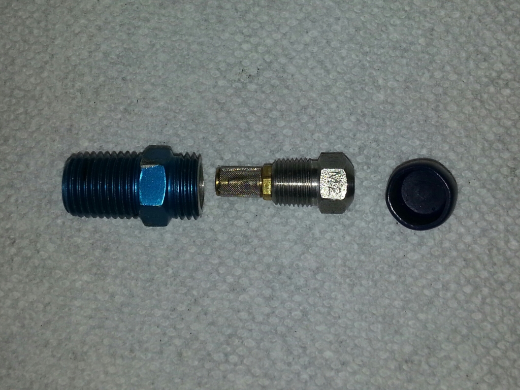

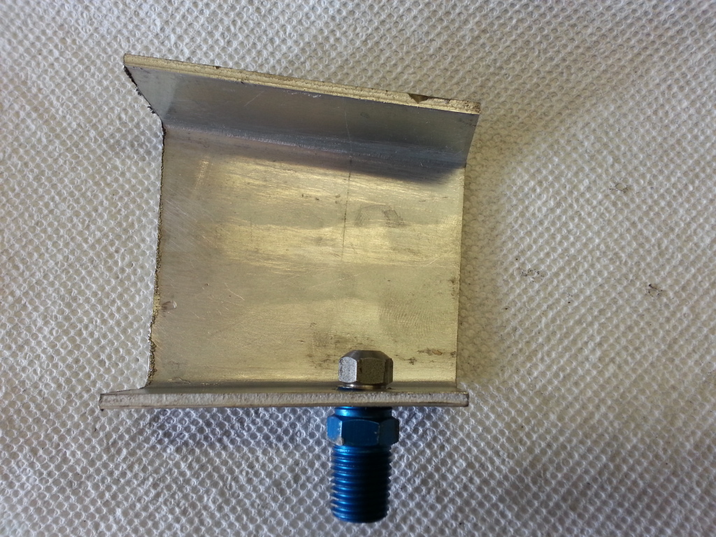

I have M2 nozzles. Here is sort of what I was thinking of doing. I have 8 nozzles, and 8 1/4 NPT connectors. I would cut down drill and tap the connector. Then insert it into the bottom of the runner. Here is a cutaway of an old runner I had. It would protrude into the port, but I would be certain that every cylinder is getting as close to an equal amount as I could get. After Richard explained the leaf blower concept I might just try it in the pipe. This idea isnt completely thrown out the window though.
Size:  505.9 KBName:  20130725_110312_zps853ae4b7.jpg

My point was methanol evaporates very quickly in moving, hot air. Looked at the devils own nozzles? Might be easier to make work.
Just checked them out. They do look pretty nice, and it wouldnt protrude into the port.

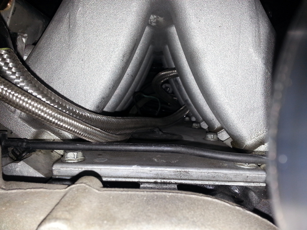

It is a little tight under the intake too. I might just try the single one for now. Im just sort of goofing off today.

The further away you can spray them into the runner the better it would work...thought about going from the top of the intake?
