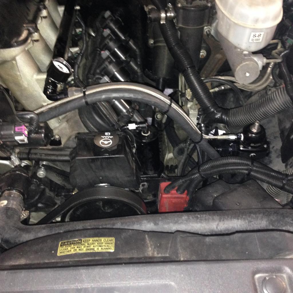

Old Aug 12, 2016 | 09:21 PM
BlackGMC's Avatar
Resident Retard
iTrader: (31)
Posts: 17,216
Likes: 20
From: Fort Worth - TX

Originally Posted by BlackGMC
SS braided vacuum line?
Yep. Pretty crazy huh. All -4AN vac/boost lines.
