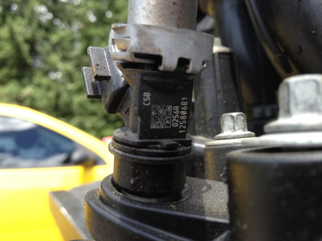

I bought an aeromotive fuel pump and regulator, still not sure what I'm doing for injectors, thinking about trying to find a flex fuel vehicle in the junk yard and taking the injectors from it. They are supposed to be 32# iirc.
I have injectors from an 08 6.0. I'll see if I can get you a part number if you're interested.
Edit- found it, it's 12580681 looks like they flow 30# and are from an 08 LY6 with USCAR EV6 connector. Here's a picture.
